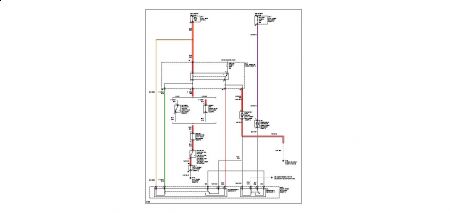

The coolent fan will not shut off, we have replaced all sensors and relays but it still runs all the time, any suggestions?

Sounds like the coil side of the fan relay is shorted to ground or a defective AC water temperature switch.
