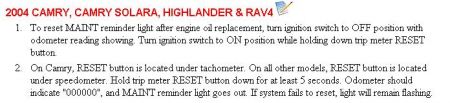

My Maintenance Required light is on, what could be the problem, had it on before but it flashed then went off, my oil change was due. This light is continiously on, what could be some possible problems.
Tuesday, August 20th, 2019 AT 12:32 PM (Merged)
BLUELIGHTNIN6
  • 16,542 POSTS
This is simply an engine oil replacement reminder. Perform the following steps to reset the maintenance reminder..

How do you reset the "maintenance required" light after the oil change has been completed?

I am changing the oil for the first time since I bought the car, I'm not the original owner. I need to know how to reset the engine maintenance light on the dash. I looked in the guide and did not find any description there.
TOYOTECH
  • 33 POSTS
Turn the key on and set the trip meter to odometer. Turn the key off. Depress and hold the trip meter button and turn the on while still depressing the trip reset button. The odometer screen will display 5 dashes, then 4 then 3, 2, 1, then all zeroes. Done. If it doesn't work try the same procedure starting from the "trip A" screen.
