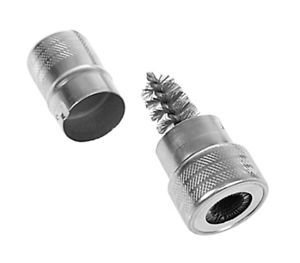

Yes. Just make sure battery positive pole goes to positive electrical clamp. Battery negative pole to negative electrical clamp. I see few topics here making a mistake. Also use this battery wire brush to clean the inside of the electrical clamp and the outside of the battery pole for proper contact.
https://images.2carpros.com/forum/automotive_pictures/89255_battery_brush_1.jpg
Computer just resets itself and will be back to normal around 30 miles.
