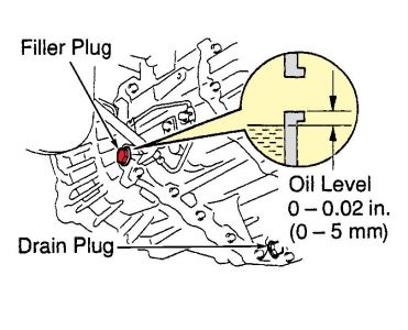

I just replaced the clutch in my wife's 2002 Camry and lost most of the gearbox oil when I separated the tranny from the motor and the right side drive shaft. When I put everything back together I can't find the fill plug for the gearbox. I found the drain on the lower front under the starter but no fill plug. Where is it?
THANKS

Look at the tranny between the firewall and tranny, it's about half way up!

This is what i have for picture
hope it will help
https://www.2carpros.com/forum/automotive_pictures/99387_toyota_fill_1.jpg
