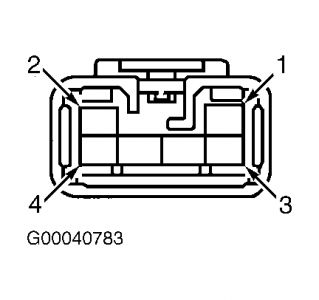

My air conditioner fan runs only in the highest speed setting of the speed selector switch.
Would the problem most likely be in the switch, the fuses, or the moror?

MANUAL A/C-HEATER SYSTEMS -2001 Toyota Camry LE Page 1 of 1 BLOWER RESISTOR Unplug resistor connector. Using DVOM, check for resistance between resistor terminals No. 1 (Blue/Orange wire), No. 2 (Black/White wire), No. 3 (White/Black wire) and No. 6 (Blue/Black wire). See BLOWER RESISTOR SPECIFICATIONS table. See Fig. 4 . If resistance is not as specified, replace resistor and retest system. BLOWER RESISTOR SPECIFICATIONS Terminals No. 2 & 4 .38 ohms,2 & 3 1.12 ohms,1 & 3 1.74 ohms Fig. 4: Identifying Blower Resistor Connector Terminals Courtesy of TOYOTA MOTOR SALES, U.S.A., INC. Ohms .38 1.12 1.74 8/4/2008
https://images.2carpros.com/forum/automotive_pictures/62217_Graphic_12.jpg

I gave up repairing the circuit myself. I figured out that the resistor needed to be replaced, but it seemed a bug job to find it and replace it. I had it fixed by the Toyota dealer. It cost $161.74
