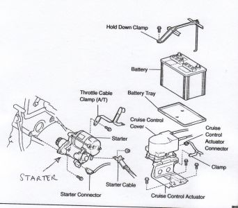

Where is the starter & how difficult is it to replace?

Located/bolted between the engine and the transmission (showing mostly above the transmission)
https://images.2carpros.com/forum/automotive_pictures/89255_starter_1.jpg
Removal: 1. Remove battery and tray. 2. If with cruise control, remove cruise control actuator. a. Disconnect the actuator connector and clamp b. Remove the 3 bolts and disconnect the actuator with the bracket. 3. Remove the starter a. Disconnect the starter connector. b.Remove the 2 bolts and the starter. c. Remove the nut and disconnect the starter cable.
