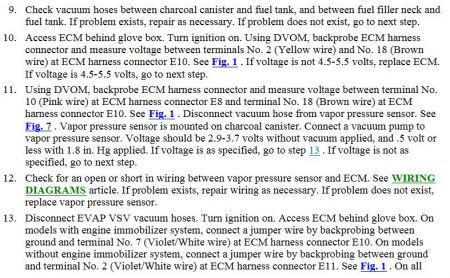

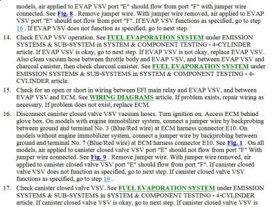

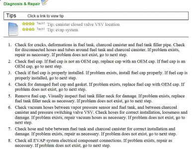

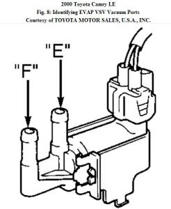

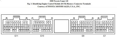

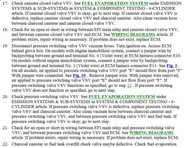

Here are the diagnostic procedures.
https://www.2carpros.com/forum/automotive_pictures/192750_P0446_00Camry01a_1.jpg
https://www.2carpros.com/forum/automotive_pictures/192750_P0446_00Camry01b_1.jpg
https://www.2carpros.com/forum/automotive_pictures/192750_P0446_00Camry01c_1.jpg
https://www.2carpros.com/forum/automotive_pictures/192750_P0446_00Camry01d_1.jpg
https://www.2carpros.com/forum/automotive_pictures/192750_P0446_00Camry01e_1.jpg
https://www.2carpros.com/forum/automotive_pictures/192750_P0446_00CamryFig01_1.jpg
https://www.2carpros.com/forum/automotive_pictures/192750_P0446_00CamryFig07_1.jpg
https://www.2carpros.com/forum/automotive_pictures/192750_P0446_00CamryFig08_1.jpg
https://www.2carpros.com/forum/automotive_pictures/192750_P0446_00CamryFig09_1.jpg
https://www.2carpros.com/forum/automotive_pictures/192750_P0446_00CamryFig10_1.jpg
Monday, July 13th, 2009 AT 10:47 AM
DOLEMITE44149
  • 17 POSTS
Perfect! It worked! Thank you for your advice.
