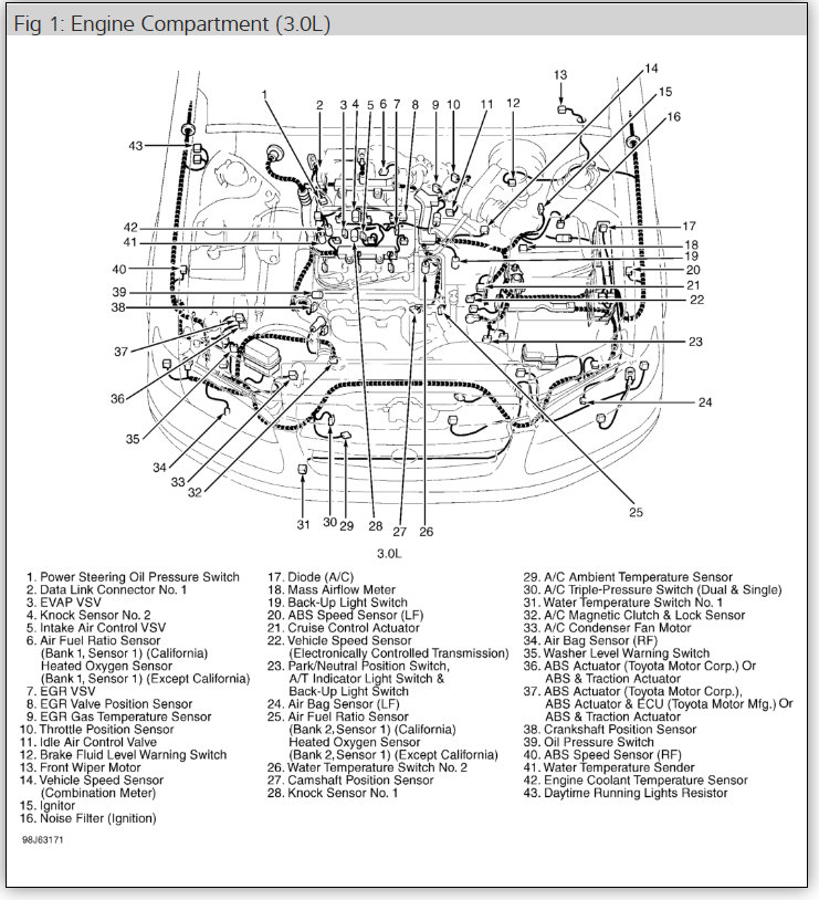

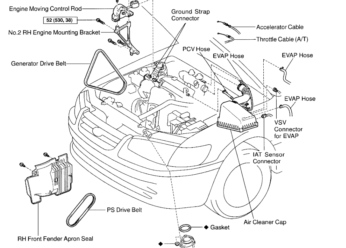

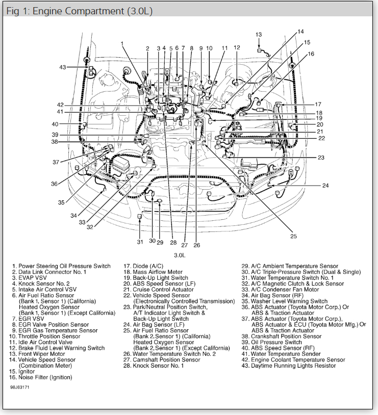

Where is the MAF sensor located and how do I remove it for cleaning?

Mass airflow meter is located on left side of engine compartment, part of air intake assembly. Here is a guide to help you see how to clean it and the location in the diagrams below:
https://www.2carpros.com/articles/mass-air-flow-service
The four and six cylinders have it in the same place, BTW. Check out the diagrams (below). Please let us know if you need anything else to get the problem fixed.
