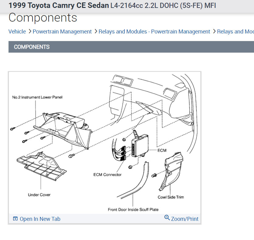

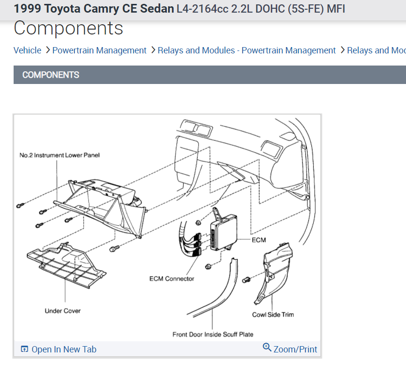

MADMIKE1735
  • 951 POSTS
Here is the ECU location. Check out the diagrams (Below). Please let us know what happens.
Thursday, November 12th, 2020 AT 6:09 PM (Merged)

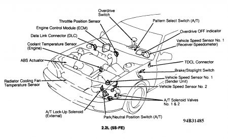

BMRFIXIT
  • 19,053 POSTS
ECU engine control module located behind right side of dash above glove box
https://www.2carpros.com/forum/automotive_pictures/99387_Graphic1_156.jpg

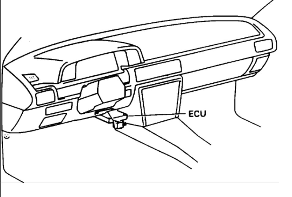

KEN L
  • MASTER CERTIFIED MECHANIC
  • 55,065 POSTS
The engine computer or ECM is located under the dash near the center by the drivers side. Here is a diagram (Below) so you can see where it is.
