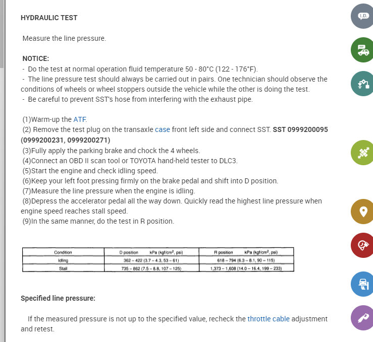

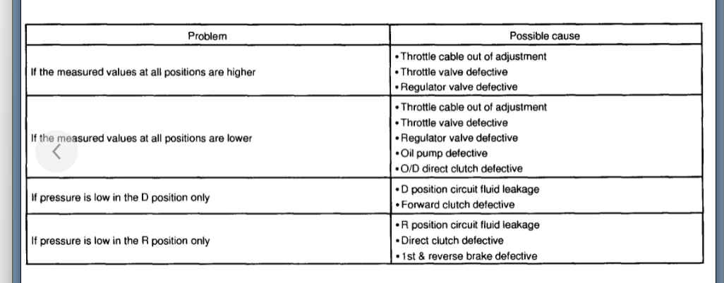

Hello there well the problem I have is that what seems to be lets say a clutch slipping thats the only way I can explain it, im driving and lets say I stop at a red light the rpm's go to like 2000 before transmission engages it does this like 2 times a day the atf is correct but the oil is a little dirty, any help will be appreciated. Thank you.
