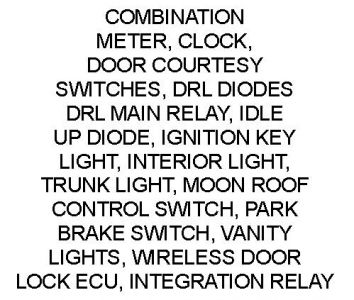

If the fuse is bad again, there should be an intermittent shorting somewhere and might not be an easy solution. Testings would have to be carried out with test lamps and DVOM. I would get the wiring schematic for you and we can try to work this out. If you had any repairs or impact damages, check those area first. The fuse blowing could be due to shorting of any of the list.
https://images.2carpros.com/forum/automotive_pictures/192750_DomeFuseControl97Camry_1.jpg
I have heard of the trunk wire harness getting caught on the left hand side hinge and that would cause shorting.

I had my dome light short out in the housing. I put. Couple o-rings on the ends of the bulb to keep it from contacting the housing and it fixed it.
