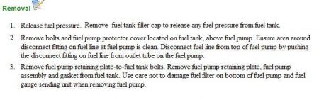

How to change the fuel pump
Thursday, July 23rd, 2009 AT 1:05 PM
BLUELIGHTNIN6
MECHANIC
16,542 POSTS
Thursday, July 23rd, 2009 AT 1:40 PM
