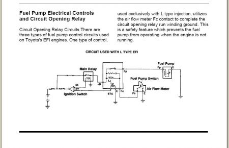

Starts for 5 seconds then stalls. Fuel pump works if I jump across open ciruit relay. Fuel pump does not run when key is in on position. Voltage at the injectors and spark at the plugs. 12 volts in one pin at harness fuel pump and 6 in the other. Fuel pump wont run unless jumped across.

Test the mass airflow sensor-it grounds the COR before it gets to the fuel pump-see below
https://www.2carpros.com/forum/automotive_pictures/12900_fp2_3.jpg
