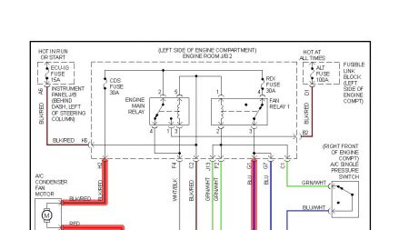

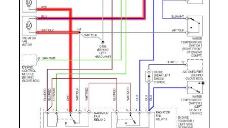

I just put in a new radiator, thermostat & coolant temp switch. I also tested the main eng. Relay, & cooling fan relay no. 1, they tested ok.I also checked for any blown fuses relating to this issue, all fuses are fine.I cant even get the A/C fan to turn on, when a/c is in use.I also ran power to both fans directly from the battery, they both turned fine. Any suggestions would be appreciated. Justo

Since you know how to test relays below is your EWD on the cooling fans.
https://www.2carpros.com/forum/automotive_pictures/12900_f1_3.jpg
https://www.2carpros.com/forum/automotive_pictures/12900_f2_2.jpg

Could my problem be a bad a/c pressure sw or maybe the diodes on the water temp sw no.1 line?
I don't know what else to try, is there something else that I maybe overlooking?

Try a jumper on each switches in the diagram. Still the same could be the computer.
