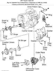

You'll need to be more descriptive to answer the final drive leak, it's part of the transmission.
https://www.2carpros.com/forum/automotive_pictures/30961_finaldr_1.jpg
https://www.2carpros.com/forum/automotive_pictures/30961_mitchel_30.jpg
There is a member called buzzass that may have an opinion on that.
The leaky tranny may be the final drive leak?

Sorry for the vague. I took it into get the oil changed and it's what the guys told me. That the Tranny gasket needs to be replaced. Also said the Final Drive is leaking bad (needed to add in 2 pints). The tranny gasket I can have done no problem, just never heard of the final drive so didn't really know what to look for in that situation.

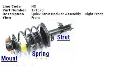

As for the struts, I called up Pep Boys and those guys will do them for $429.87 plus tax. Sound reasonable?
I agree with the driving cheap comment, I just don't want my tranny to go out soon after I do all this work. Being that I am up in the 225k range, I don't know how long those bad boys last. Besides the little leaks, it seems tip top shape.

I would want to know if the mounts and or springs are included in that. I would suggest a quick strut assy that includes it all. A little pricier, but at that mileage, it will make a difference.
https://www.2carpros.com/forum/automotive_pictures/30961_strut_2.jpg
Struts and springs go hand in hand IMHO. The mount it probably the noise your hearing. Contact a few independent shop, the chains make me shiver. You may even want a quote from the dealer...sometimes that can be competitive.
