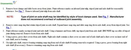

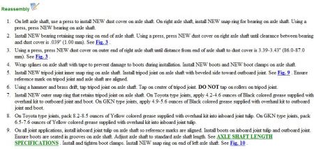

Trying to replace the old axle with a new one. I removed both the snap ring and the bolt on the carrier/engine mount, and still axle won't come out. There was a good amount of rust behind snap ring and guessing it somehow got between bearing and where it seats into carrier/engine mount. What would be the best way to get it free? Is it possible to remove drivers side axle and pound it out with a large brass punch? Have tried heat, impact hammers and large pry bars and just about ready to try something drastic but don't want to cause additional damage in process. Any help would be great.

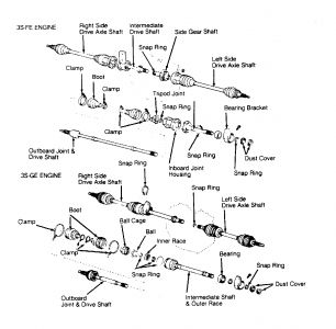

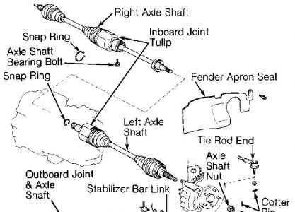

Hello Jeff !!
which snap ring do you removed?
Here is an schematic of the drive axles of your car:
https://www.2carpros.com/forum/automotive_pictures/576_camry_4_cyl_95_1.jpg
Let me know to continue..
Good Luck!

JLUCE
Hey Fisherman,
Thanks for the reply.
The larger of the two that keeps the bearing in place. The funny thing is the new axle has no snap ring on the inner spline. Think they are refering to drivers side I know that one does. Let me know if know any tricks to get this out it's driving me crazy.

FISHERMAN
  • 937 POSTS
Hey Jeff, the one on the inboard joint tulip?
Did you remove the axle shaft bearing bolt also?
That bolt keeps the bearing on place.
Let me know if I`m going wrong.
(tonight I`ll post the bottom portion off the picture (to big and the resolution gets bad when post a big pic.)

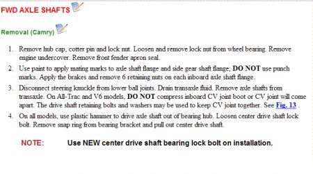

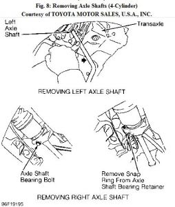

FISHERMAN
  • 937 POSTS
Hello Jeff !!
I have more pics for you and you`re right... you have to use a hammer and a brass chissel avoiding to damage the bearing..
https://www.2carpros.com/forum/automotive_pictures/576_camry_4_cyl_95jpg1_1.jpg
https://www.2carpros.com/forum/automotive_pictures/576_camry_4_cyl_95jpg12_1.jpg
https://www.2carpros.com/forum/automotive_pictures/576_camry_4_cyl_95jpg123_1.jpg
let us know if the info was helpfull !!
Good Luck!!

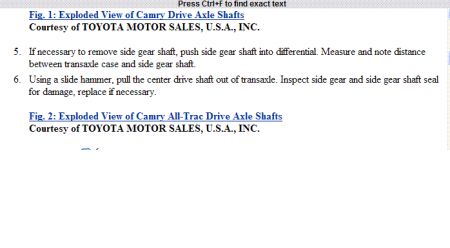

The driver side axle broke. I got a new one. Apparently there are supposed to be bolts (6 I think) at the transmission to bolt the end of the axle to. I think these bolts broke and caused my failure. Can I replace this thing just inside the transmission without taking the transmission out?
Monday, May 27th, 2019 AT 2:49 PM (Merged)

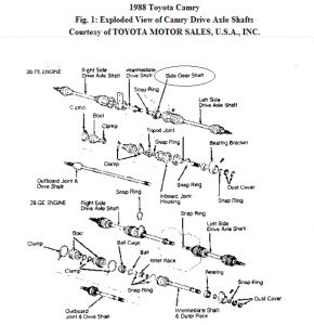

IMPALASS
  • 3,112 POSTS
Hello
It appears that you can use a slide hammer. I have attached the information. .
Hope this helps
https://www.2carpros.com/forum/automotive_pictures/248015_Camery_drive_shaft_3_1.jpg
https://www.2carpros.com/forum/automotive_pictures/248015_Camery_drive_shaft_1.jpg
https://www.2carpros.com/forum/automotive_pictures/248015_Camery_drive_shaft_2_1.jpg

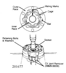

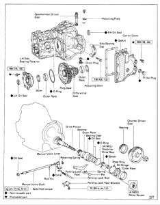

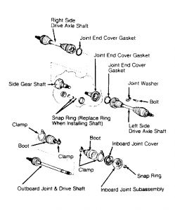

IMPALASS
  • 3,112 POSTS
Hello
https://www.2carpros.com/forum/automotive_pictures/248015_1_16.jpg
I will do the best I can to explain and if you still don't understand I will forward to another moderator. If we look at the first pic, the side gear shaft has a snap ring on the end of the shaft that helps hold it in to the transaxle. You need quite a bit of force to pull the side gear shaft out to over come the snap ring holding it in. Thus the use of the slide hammer. The ones I have seen stick out past the end of the axle. . .. . ..long. You may not have one or be able to get one. You might consider checking with a transmission shop and see if they would rent you one. I would imagine it bolts up to the shaft and the nuts that hold the left drive axle shaft to it then hold the slide hammer to it. A couple of good slides and out it should come.
In another section discussion seal replacement, I have attached that for you, as you see in step 5 you need a special tool, SST 09350-32010 or equivalent to drive out the side shaft. In step 7 you need a special tool to install the seal. When you get to step11, you use a different special tool to install.

You may not have the special tools for this task.
https://www.2carpros.com/forum/automotive_pictures/248015_2_12.jpg
https://www.2carpros.com/forum/automotive_pictures/248015_3_6.jpg
If I understand the next part of your question about the gear being pressed on, I have attached a pic of that. As you see you can use a plastic hammer to drive that apart.
https://www.2carpros.com/forum/automotive_pictures/248015_4_5.jpg
Your question about the covering at the side. If we are talking about the same thing, I have attached a pic, you are looking at the bearing retainer which gets you into the deferential area. If you remove this you will need to replace the O ring also.

Hello you are in no way bothering me so don't concern yourself there. If you provide me an email address I can send the pics to your email, then you can open them up as pictures and use the + and - to make them bigger or smaller. Also, you can right click on the pics, save them to a file on your computer and double click them there and they will open up and you can use the + and- again to make them bigger or smaller.
It is hard not to be standing there, both looking, pointing and talking about the same thing. That is not easy.
Okay, if you look at the first pic I sent Fri Oct 24 at 5:52 pm, there is a picture of the axles, I circled the side gear shaft. From what I see, the axle connects to this with nuts. Bolts are on the side shaft. The side shaft slides into the transaxle. Right behind the side shaft is the left bearing retainer that is bolted onto the transaxle and has the oil seal that the axle slides through. If I understand you correctly you have the axle off. The next thing to remove is what the axle is bolted to, the side shaft. You have to use the slide hammer to remove the side shaft to get to the bearing retainer that is bolted to the transaxle.
Does this help at all..... Are we talking about the same thing? I hope this helps. You are probably correct, improper installation or even defective parts may have made it come apart.
