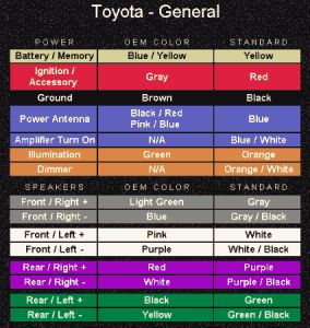

My girlfriend has a camry and her dad went to change the stock radio to a new cd player. the radio works fine but the problem is that the lights in the dash where the speedo and everything is dont swith on when the lights are turned on. does this have something to do with the way he has wired the radio. i have looked at wiring diagrams and he hasnt connected the illumination wire is this needed or would it be another problem. any advise is much appreaciated.

he hasnt connected the illumination wire is this needed. It suppose to be hook up with the circuit that illuminates the dash lite. That way when you dim the dash lights the player dims too. Look below how toyota's sound system is wired in.
https://images.2carpros.com/forum/automotive_pictures/12900_radio_color_codes_1.jpg
