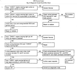

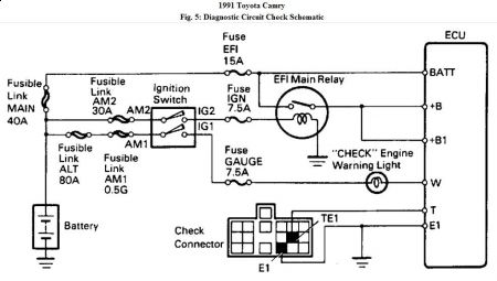

KHLOW2008
  • 41,814 POSTS
You would have to check why the CEL is not indicating when ignition switch is turned ON.
https://www.2carpros.com/forum/automotive_pictures/192750_DiagnosticCircuitCheckFig05_1.jpg
https://www.2carpros.com/forum/automotive_pictures/192750_DiagnosticCircuitCheckFig06_1.jpg
+1
Monday, February 22nd, 2021 AT 10:53 AM
MATER007
I followed the schematic directions as to how to check the CEL when I grounded the wire that comes from the CEL to the ECU to the frame the CEL came on.I then grounded the E1 terminal in the data link directly to the battery the CEL still did not glow.
+1
KHLOW2008
  • 41,814 POSTS
The ECU or its witing is faulty and not grounding the circuit.
Recheck the ECU wire connectors and termnals for contaminations. If none found, you would have to get an ECU to test.
