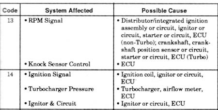

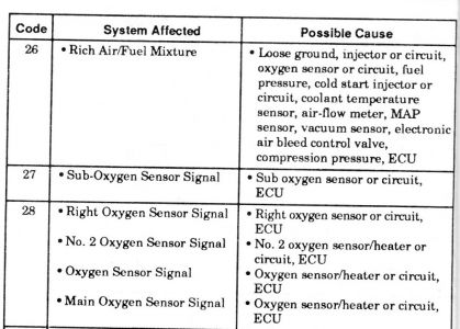

I HAVE A 1991 CAMRY 4 CYLINDER.
THE ENGINE LIGHT COMES ON SOMETIMES.
I DID A DIAGOSTIC TEST.
THE CHECK ENGINE LIGHT BLINKED IN THIS ORDER.
( 1 BLINK, 4 BLINKS, 2 BLINKS, AND THEN 7 BLINKS)
THEY BLINK IN THIS ORDER, BUT NOT SURE WHICH IS FIRST
I CAN'T FIND THAT CODE IN MY CAR MANUAL.
CAN YOU TELL WHAT THIS MEANS?
Friday, September 17th, 2010 AT 4:21 PM
DSPLC
  • 220 POSTS
1 blink 4 blinks (code 14)

2 blinks 7 blinks (code 27) Oxygen sensor underneath the middle of the car after catalytic
