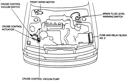

In the process of troubleshooting my cruise control system, i found that the reason my cruise control was not functioning was because of a missing vacuum line. I then checked for vacuum lines that were not connected to anything. What i found was a vacuum line connected to 2 vacuum ports. I proceeded to to disconnect one side of the line and connected it to the cruise control. The question that i have is where can i find a better vacuum system diagram since the one on the car doesn't include everything?

yes ,The cruise control is vacuum actuated on the 1983-91 models. there is only vacum system diagram for the emission system under the hood, I do not see a diagram for the cruise control either. Is the cruise control working after you connected the vacuum line?
https://images.2carpros.com/forum/automotive_pictures/46384_cruise_control_loc_1.jpg
Oct 3, 2009 at 5:42 AM
CELTICDRAGONMASTER
yes the cruise control works fine, i just have an extra vacuum port that i wanted to make sure didn't go anywhere before i plug it up.

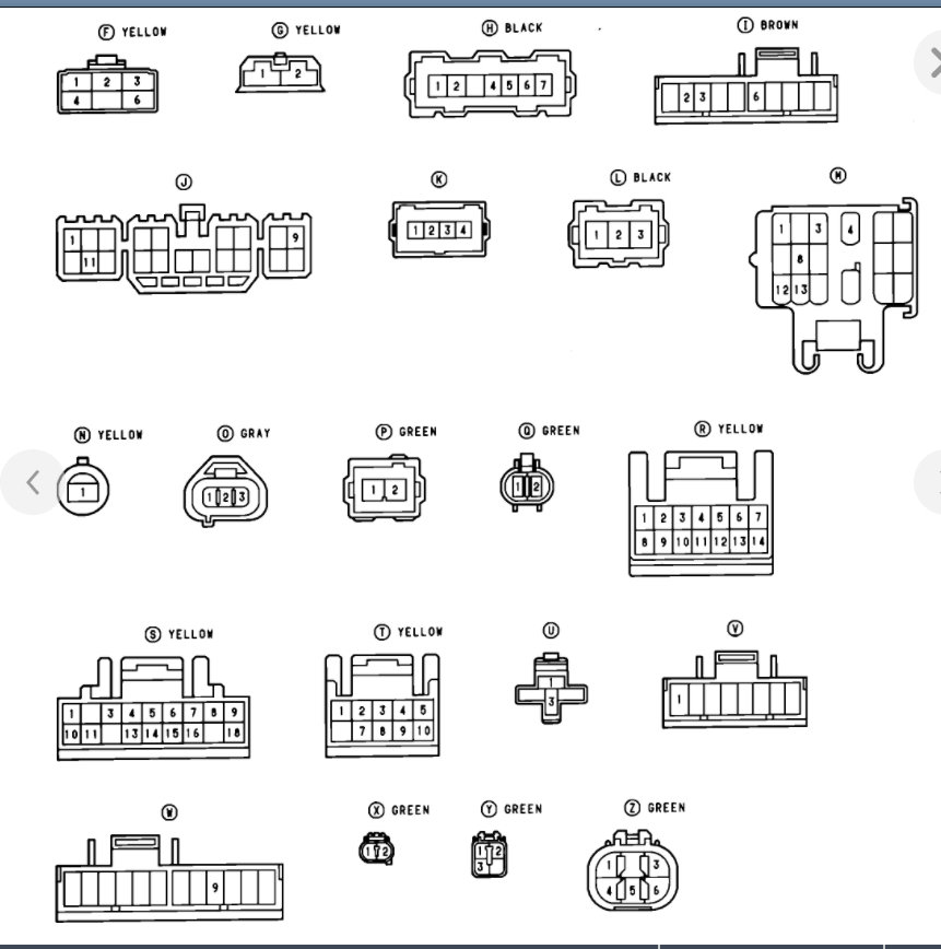

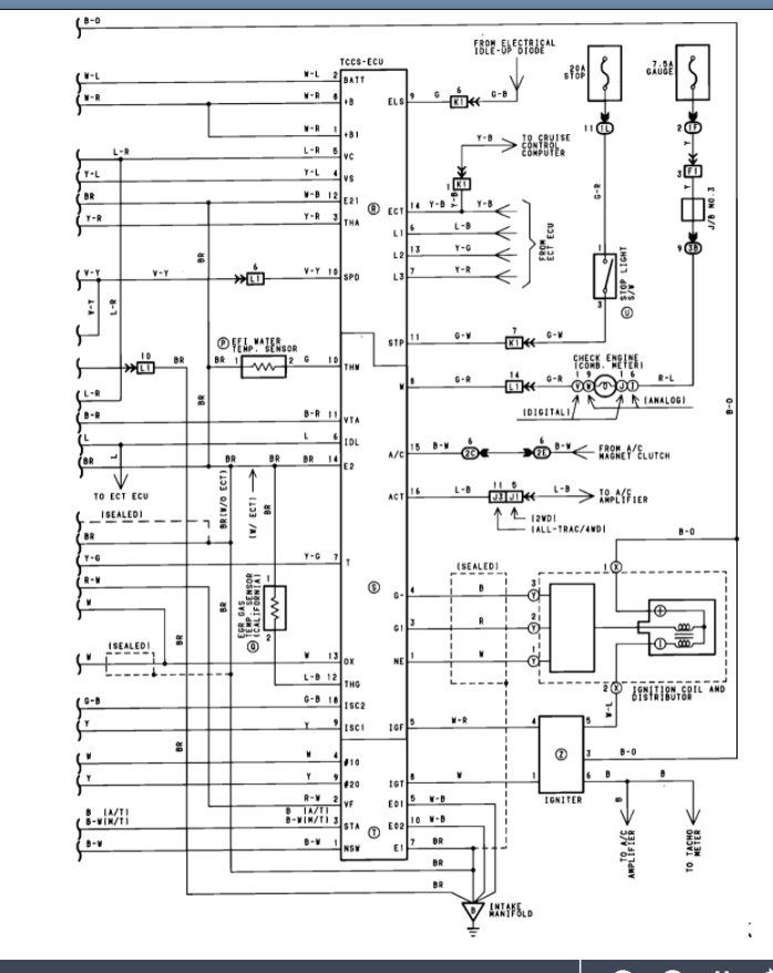

KENE THANKGOD

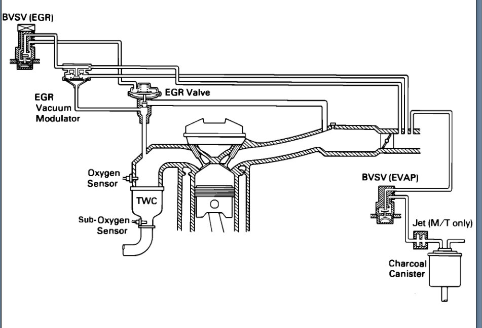

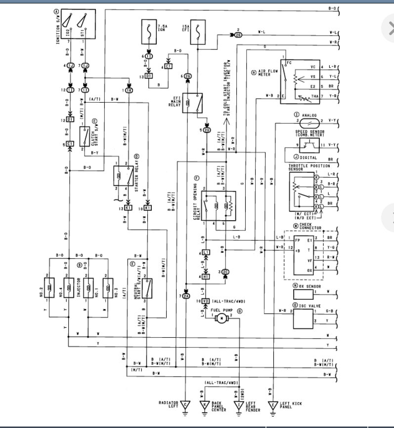

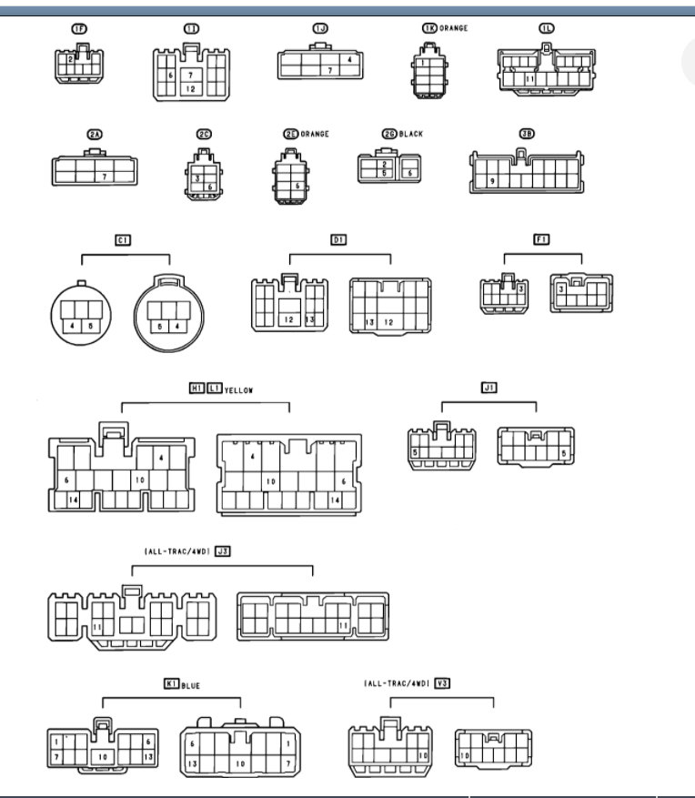

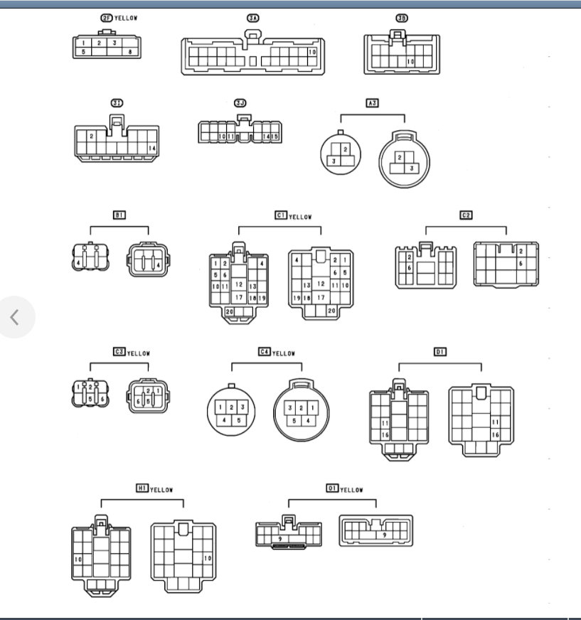

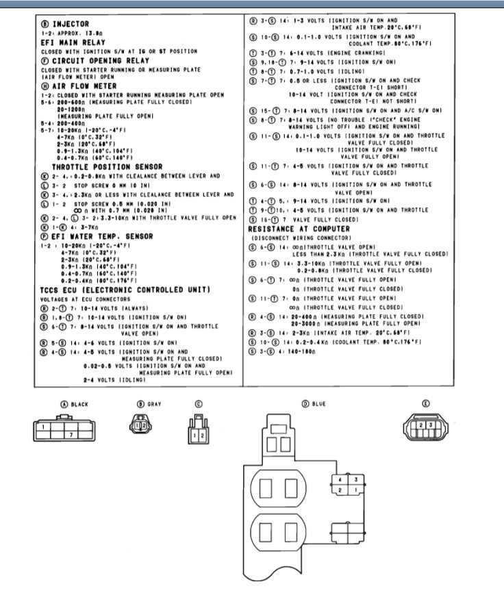

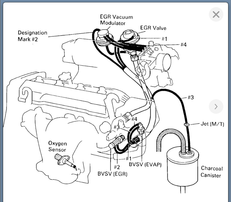

I have a Toyota Camry 2.0 Sportwagon 3s engine 1988 model. please i need the vacuum diagram and the wiring harness diagram.
Jan 20, 2022 at 8:10 AM
No problem. Here is a guide as well that will help with any vacuum leaks in case you need it:
https://youtu.be/4ktw1X4W_-k
Below is what the manual has on the vacuum diagrams and wiring diagrams including all the connector views.
Let us know if you need more info. Thanks
