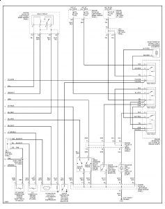

Not a problem. Actually, I was looking over wiring schematics for your exact car. It is located in the left front inner fender. The wires should be yellow, blue with black tracer (2 of them), and red with a white tracer. Here is a picture of the schematic. I had to enlarge it to read it. Let me know if it helps.
https://images.2carpros.com/forum/automotive_pictures/249084_aaaa_2.jpg
Joe PS: Have a great Easter!

Thanks. Hope you had a Happy Easter as well. No this did not help me at all. I print it, I cant see it, i blow it up, I cant see it. So am I to understand that i dont have a regular old A/C relay that I can pull out with some vice grips (yoink!) and pop a new one back in? i did find some additional relays but they were for something else other than the A/C. also according to a part that i googled which says its my A/C relay (as per a different site) the prongs were different. that site did not give the location where the relay should go either. I just need to know specifically where the A/C relay goes. Unfortunately i live in the TAlanta are and the pollen count is 1600+ so I will have to take the car in to have someone look at the A/C by Wed of this week becasue I can not continue to have the windows down and ride without sever reprecussions to my respiratory function. If you can, please advise. If not, I understand. Thanks.

Actually, according the schematic, it should be located on the left front inner fender. The wiring going to it should be the colors I described. As far as replacing it, all my information shows a relay (removeable) so you should be able to just unplug it and replace it.
Would it help if I tried to email the schematic to your personal email? Maybe then you could copy and paste it to paint book and enlarge it to actually see it. Also, when you look at the picture I sent, it is located at the top left.
Let me know if you can think of a way for me to send a better copy.

i dont think it will help. i dont even see the relays to which you are referring. per the manual and all other sources i have checked there should be no additional relays. i have been informed that the relay that controls the A/C is the MG/CLT relay.

I'm sorry that didn't help. I was just reading from the schmematic. According to it, that is the relay. As far as the breathing problem, I understand.
