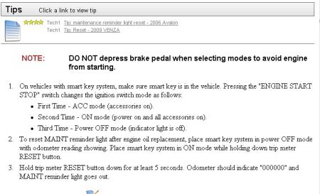

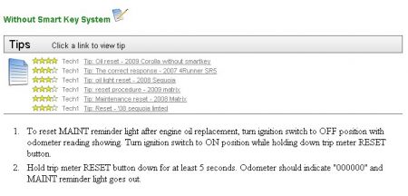

How to reset maintenance light after an oil change?
Saturday, February 20th, 2010 AT 12:05 PM
LEGITIMATE007
MECHANIC
5,121 POSTS
Saturday, February 20th, 2010 AT 3:55 PM
