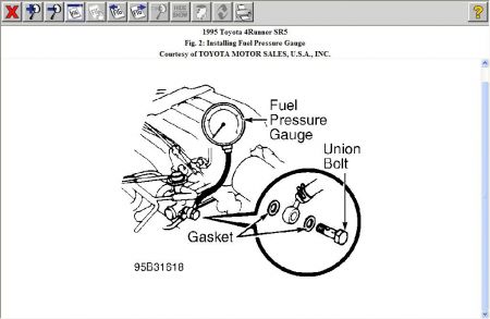

Whers is the location of the fuel pump wiring harness. I'm trying to depressurize the fuel system to change the filter

The harness is near the top of the fuel tank-do below to relieve fuel presssure. Loosen the union bolt.
