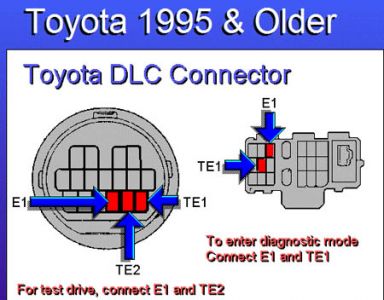

My hilux shakes while accelerating and when I take my foot of the accelerater it stops. I think it comes from the engine. The idling fluctuates when not moving and the gear stick shakes abit also

Check for stored codes...
https://www.2carpros.com/forum/automotive_pictures/62217_95AndOlder2_3.jpg
https://www.2carpros.com/forum/automotive_pictures/62217_95AndOlder3_3.jpg
Write down your findings and post the results...But when was your last complete tune up? Filters?
