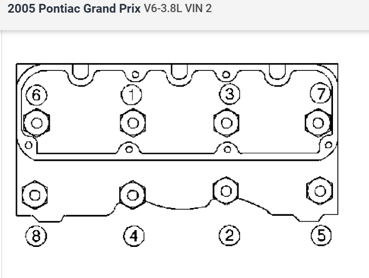

Torque specs head bolts to the upper intake manifold?
2005 PONTIAC GRAND PRIX
320,000 MILES • 3.8L • V6 • 2WD • AUTOMATIC
SCOTTSOSA_18

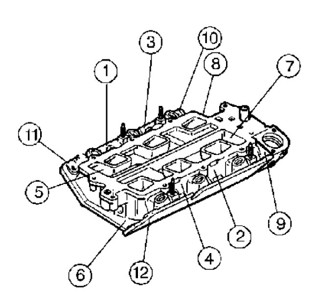

I had a blown head gasket and replaced everything but before I put everything back togeather again I need to know the exact torque specs each set of bolts starting from the head bolts to the upper intake manifold. I keep getting different specs from 22 ft/lbs to 37 ft lbs.
Dec 15, 2025 at 10:31 AM
  • 55,006 POSTS
The cylinder head bolts are torque-to-yield so you will need a new set.
First Pass .................... 50 Nm (37 ft. lbs.)
Final Pass .................... 120 degrees
The intake are:
Tighten the lower intake manifold bolts in sequence
L26 to .................... 15 Nm (11 ft. lbs.).
Check out the images (below). Let us know if you need anything else.
