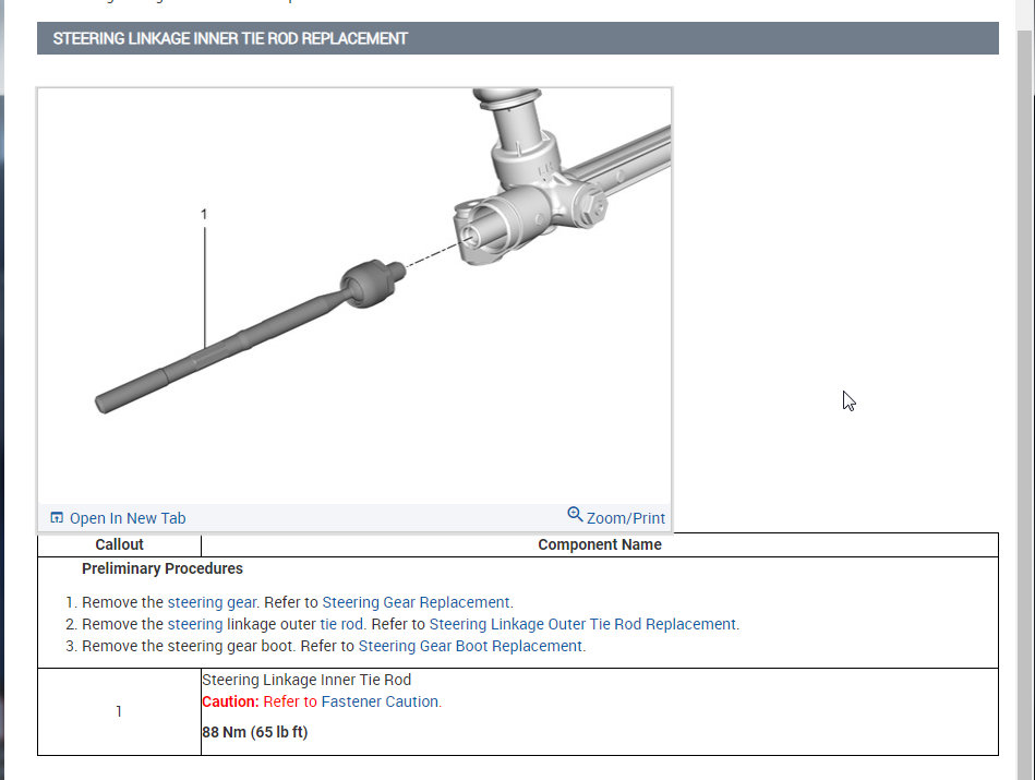

tie rod Torque specifications
2016 CHEVROLET SPARK
60,000 MILES • 1.2L • 4 CYL • 2WD • AUTOMATIC
MILIGANCORY42
Inner tie rod to rack opinion.
Nov 27, 2020 at 10:11 AM
  • CAR REPAIR CONTRIBUTOR
I attached the process and it includes the torque spec. Let us know if you need more info. Check out the diagrams (Below). Please let us know if you need anything else to get the problem fixed. Thanks
