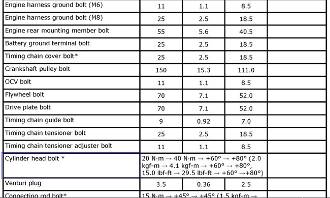

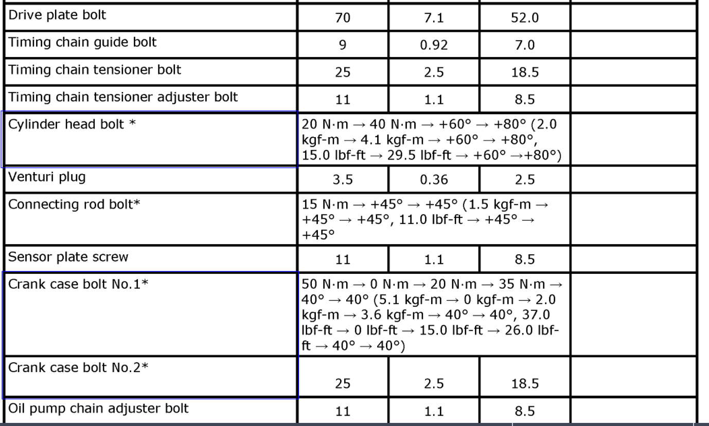

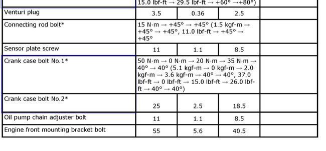

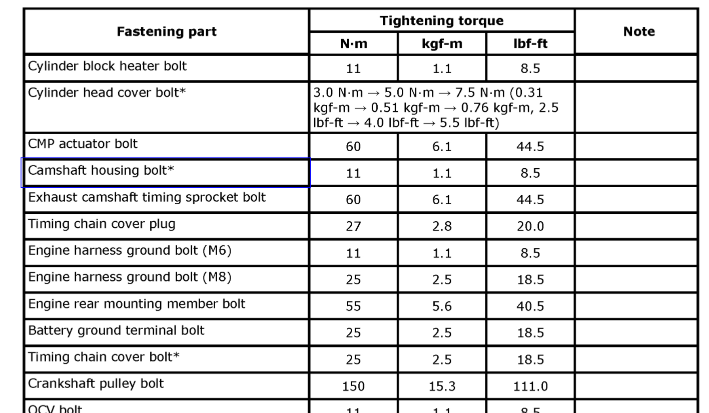

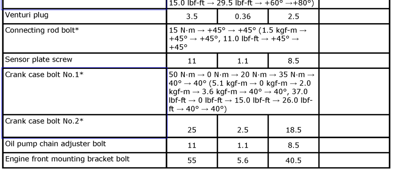

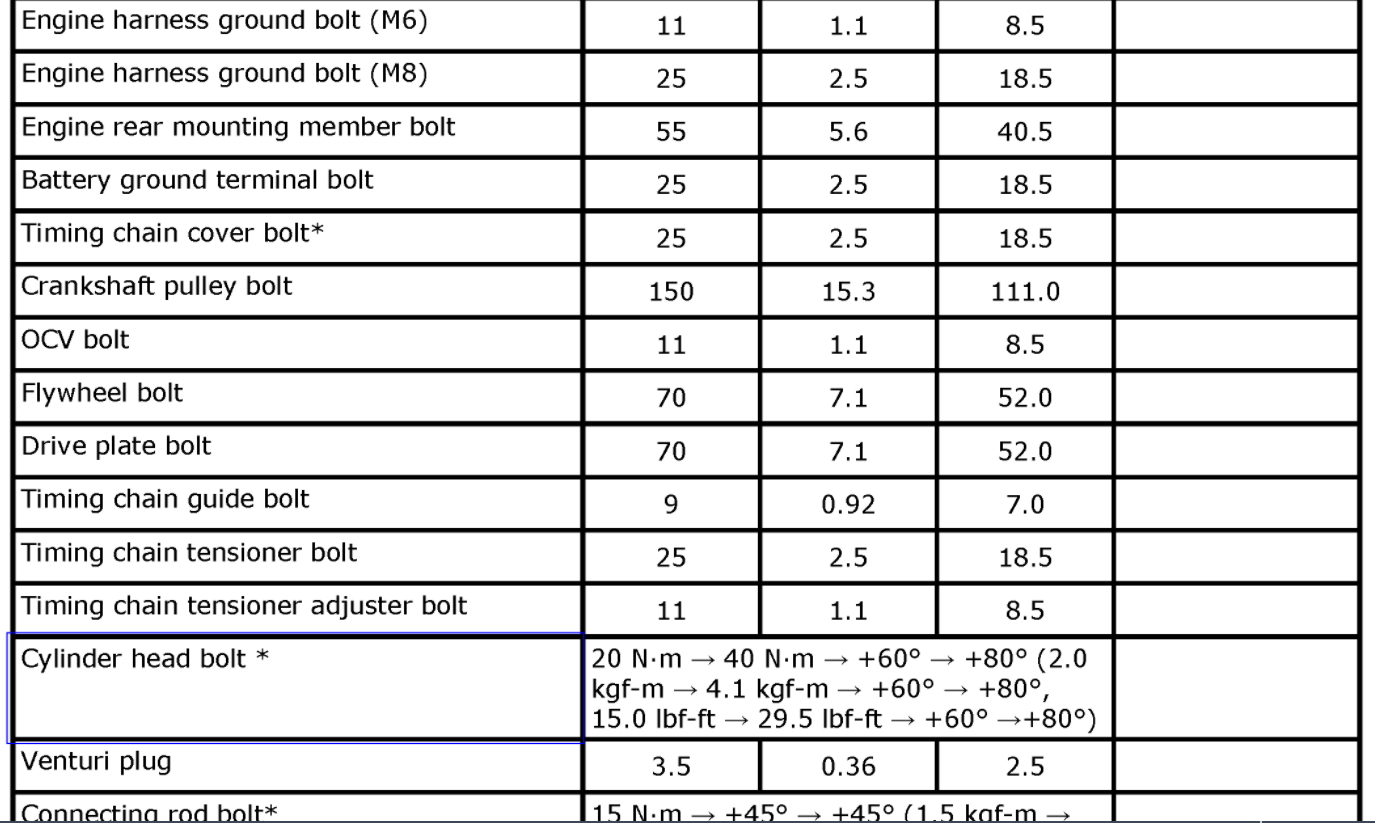

Can someone help me with 2.4 j24b
Head bolt
Main bearing
And conrod bearing
Torque specifications.
I'm stuck now rebuilding my vehicle listed above as the guy who was working on it stripped it apart and disappeared.
Thanks in advance.
Regards,
DHARMESH
Mar 11, 2021 at 8:59 PM
  • CAR REPAIR CONTRIBUTOR
Good morning,
I attached below all the torque specs for the motor for you to view.
Make sure you replace the cylinder head bolts with new bolts. It is not recommended reusing the old bolts.
