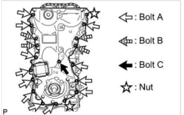

2.7L, not the 3.5L. Has 2 nuts, 12mm and 14 mm bolts.

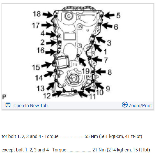

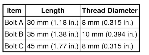

Here is the torque specs and bolt lengths for the timing chain cover as requested.
2011 Toyota Highlander 2.7L 4-cylinder — 1AR-FE
Timing chain cover bolts/nuts:
80 in-lbs / 9 N·m for the smaller cover bolts
Some larger fasteners may be higher depending on bolt location.
Check out the images (below). Let us know if you need anything else.

What are they referring to in the first sentence of 9nm, the 2 nuts?
May 6, 2026 at 8:05 PM
  • 54,487 POSTS
Good question, they do not mention the nuts, they show them in the diagram but no torque spec.
