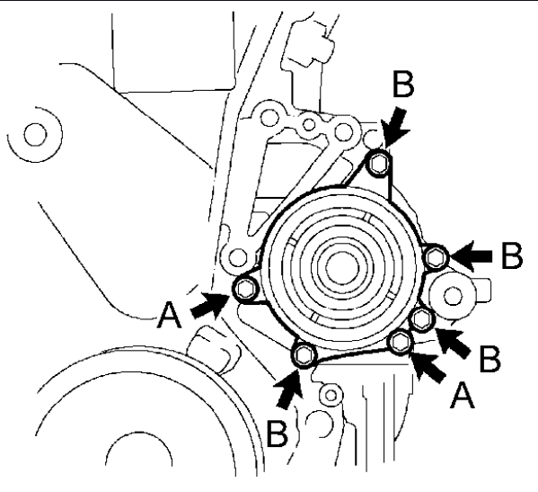

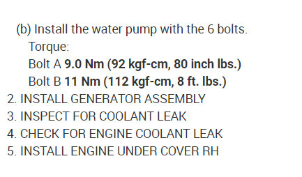

can I get the torque spec of the bolts of the water pump?
Thank you

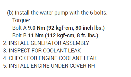

Hello, I'm Danny.
I've attached 2 pictures below of the torque specification for the water pump you asked for. Check out the diagrams (Below). Please let us know if you need anything else to get the problem fixed.
