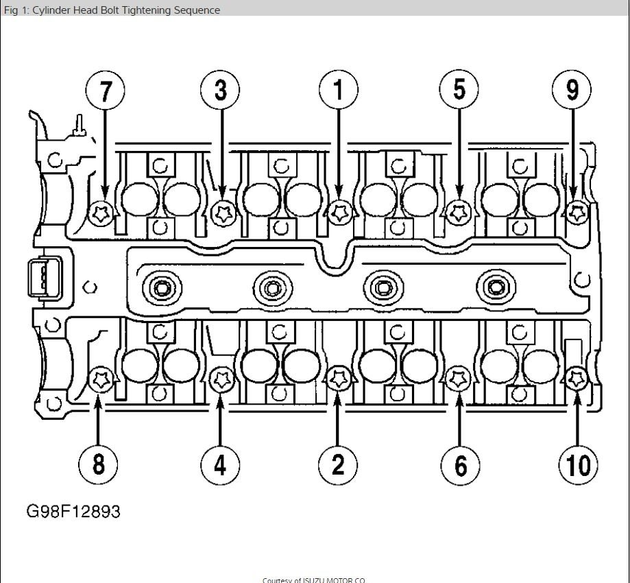

Good day, please help me me torque settings for vehicle listed above (petrol).
Apr 10, 2018 at 2:41 AM
PATENTED_REPAIR_PRO
CAR REPAIR CONTRIBUTOR
1,853 POSTS

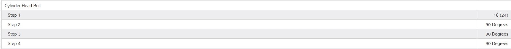

This is for a 2.2, the 18 (24) is ft lbs and nm.

Thank you very much in advance. I will now start assembling.
