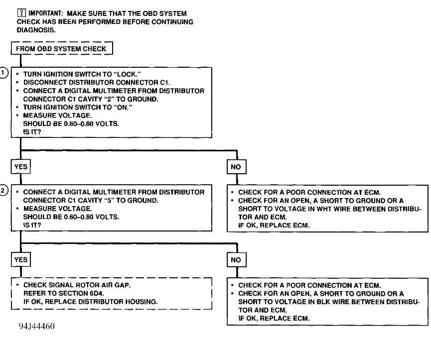

car purrs like a kitten until i put it in gear, then it drops dead replace it in park are neutral and starts right up.

scan for codes and check fuel pressure with a gauge auto parts rent it. also clean throttle plate on both sides and iac hole with choke cleaner.

it may not be torque converter clutch solenoid causing problem. check engine light would be on as well.

Got code 13 says no crank angle. But I replaced distributor and timing belt. All OME parts.

check for a cracked distributor or rotor cap and connections at ECM then follow checks on chart. that code means there is no rpm signal so it may be a bad ECM.
