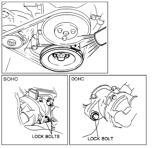

How do you find TDC on the vehicle listed above DX SOHC? Thank you
Friday, January 17th, 2020 AT 6:37 PM
9 Replies
  • 110,194 POSTS

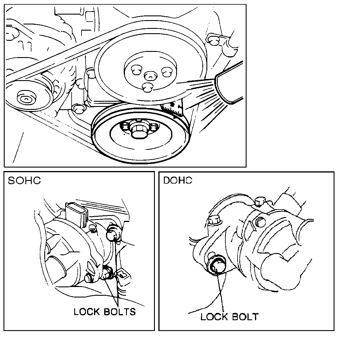

If you are just trying to locate TDC with the engine together, on the crankshaft pulley, there is a notch. It needs to be aligned with 0 degrees or TDC on the indicator located on the timing belt cover. I attached a pic.
If you are replacing the belt or trying to install the distributor, let me know. With the timing belt cover off, you need to use different marks, so let me know if that is what you are doing.
I hope this helps.

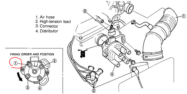

I am trying to install a distributor. So what marks do I use?
Saturday, January 18th, 2020 AT 11:43 AM
  • 110,194 POSTS
You will need to have the crankshaft on TDC and when installing the distributor, the rotor should point at where the number 1 spark plug wire will be in the distributor cap. Here are the directions. I attached a picture and circled the number 1 spark plug point on the distributor cap.

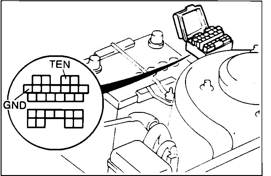

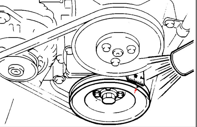

Once installed and the engine starts, you will need to fine tune the timing. You will need a timing light to do this. Here are the directions. The last two pics correlate with these directions.
1993 Mazda Protege L4-1839cc 1.8L SOHC
Ignition Timing
Vehicle Powertrain Management Emission Control Systems Adjustments Ignition Timing
IGNITION TIMING
PREPARATION
Diagnosis Connector
pic 2
1. Warm engine to operating temperature.
2. Turn all electrical loads "OFF."
3. If using Mazda System Selector (SST #49 B019 9A0), connect to diagnosis connector. Set switch "A" to position "1" and test switch to "SELF-TEST" position.
4. Connect tachometer and timing light.
NOTE: If Mazda SST is not used, install a jumper wire between diagnosis connector "TEN" and ground terminals.
ADJUSTMENT
Timing Adjustment
pic 3
1. Following preparation, check if timing mark (yellow) on crank pulley is aligned with mark on timing belt cover:
5° ± 1° BTDC
2. If adjustment is required, loosen lock bolts and turn distributor as needed to align timing marks.
3. Tighten lock bolts to 19 - 25 Nm (14 - 19 ft. Lb).
4. Following adjustment, remove SST or jumper wire.

In order to have the #1 cylinder at TDC. Does this mean having the notch on crankshaft pulley aligned with 0 degrees on the timing belt cover? Thanks
Saturday, January 18th, 2020 AT 7:26 PM
  • 110,194 POSTS
Yes. The 0 indicates TDC (0° before or after TDC). You will notice there are numbers with degrees both before and after the 0. When you use the timing light, that notch will light at some point on the cover. Then you can move the distributor one way or the other to achieve the correct timing. The procedure indicates 5° BTDC. That means the spark plug will spark 5° before the piston actually reaches TDC.
I hope that makes sense. Please feel free to let me know if you have other questions.

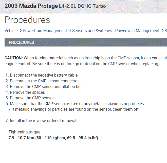

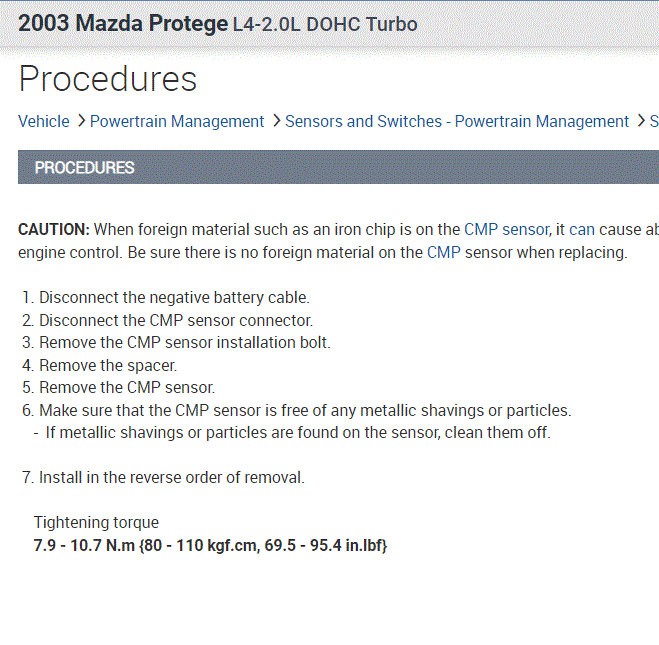

I have a 2003 Mazda Speed Protege, and I have to switch out the crankshaft sensor. What tooth on the crankshaft do I have to line up with the new crankshaft position sensor once I’m at TDC?
Friday, October 1st, 2021 AT 2:43 PM
  • 110,194 POSTS
If you are only replacing the sensor, there is no need to worry about timing. The sensor reacts to a toner ring that isn't adjustable, so the engine timing can't change that.
Simply remove the old one and install the new one.
If you look at the attached pic, it provides the directions specific to this vehicle for sensor replacement. Also, here is a link that explains in general how it's done:
See pic below.
