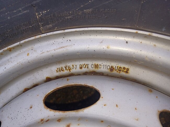

Also, is it normal for rim to be measured to sixteen inches with tape measure and tire is fifteen inches?
Dec 28, 2023 at 5:42 PM
  • 110,193 POSTS
I suspect you are measuring it where the tire bead sits against the rim. The diameter is larger there, so what you indicated sounds correct.

I can't see my replies. Did the last one with pic go through?
It looks like i got this.
And pattern is 5 X 4. 5..5 lug, from what I've found online?

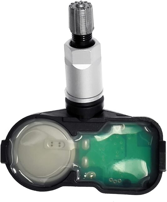

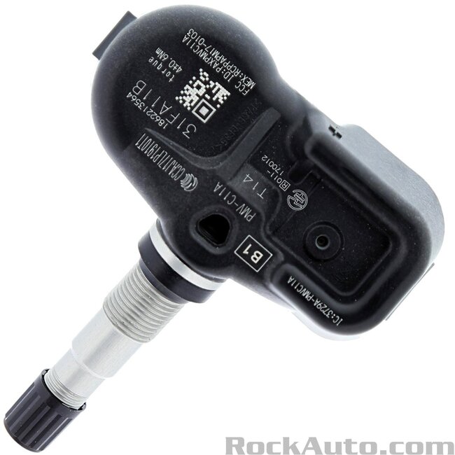

For some reason i can't see the recent reply i sent. here's a pic of what looks like a battery in it. not sure if its replaceable.
Dec 31, 2023 at 9:30 AM
  • 110,193 POSTS
That is correct. However, that is sealed inside the unit, and (to the best of my knowledge) it isn't replaceable.

I saw some videos of replacing the watch battery 2032, an resoldering it on YouTube, lol i may try it for fun. But if i get that tool that reprograms it to truck an new sensors. will that fix them? I saw some were for steel rims and others for alloy. my new rims are not steel. Will that factor it?
Dec 31, 2023 at 11:09 PM
  • 110,193 POSTS
The tool I have is somewhat expensive, so you may want to have it done when the new wheels are installed. Also, a different wheel shouldn't change how the sensor functions.
