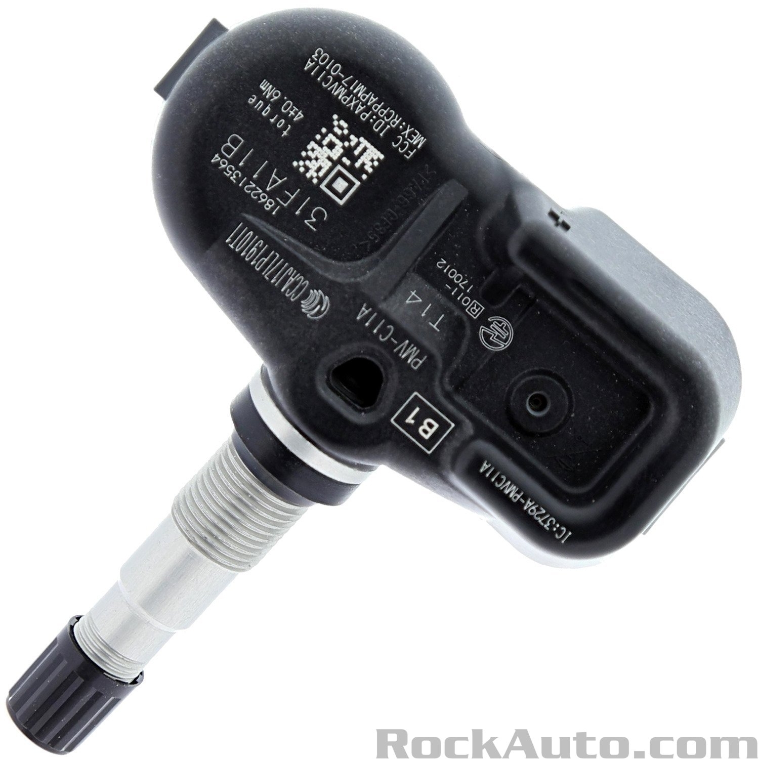

Chances are a battery has failed on one of the wheels. I used a tool specifically designed to test for a signal from each wheel. In this case, you will likely need to take the vehicle to a tire shop and ask if they can test the sensor in each wheel.
The batteries usually last 5-7 years. You are well beyond that, so chances are they aren't original. This is my first suspect.
Let me know your questions.

  • 107 POSTS
Is this a replaceable battery in the sensor or is it a one and done sensor replace and reprogram only?
Also, if I get new wheels can I disable this option and what if they are not steel but alloy or aluminum?
Thanks
Wednesday, December 27th, 2023 AT 10:54 PM
  • 110,192 POSTS
The battery is integral to the sensor. So, it will need to be replaced. I'm not sure where you are located so I don't know what people are charging to do it. The tire needs to be removed from the wheel or the bead broken on the side of the sensor. The old sensor is removed, and I simply copy the frequency from it and load it to a new sensor. Once the new one is installed, if the tire isn't completely removed, it just needs to be aired back up. If it was removed completely, then it will need to be remounted and balanced.

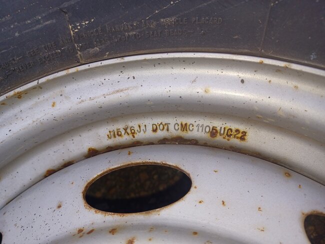

I can't see my replies. Did the last one with pic go through?
It looks like I got this.
And pattern is 5 X 4. 5.5 lug, from what I've found online?
Is there a chart at what other trucks and cars are interchangeable?
Is it possible to go to a 16-inch with same pattern on rim? Or will I have trouble being 4 cylinder, etc?
And will that make any new sensors, if I even get them, inoperable since my computer is set for oem 15?

  • 110,192 POSTS
Yes, you should be able to find a 16" rim with the correct bolt pattern. As far as the TPMS, no, the wheel size will not make a difference.
Just remember, when you don't want to put tires on it that are too big and may rub. So, make sure you do a comparison between the OEM tire size and what you want to install so there is enough clearance. Yes, you can go bigger if you want, but check for clearance before making a decision.

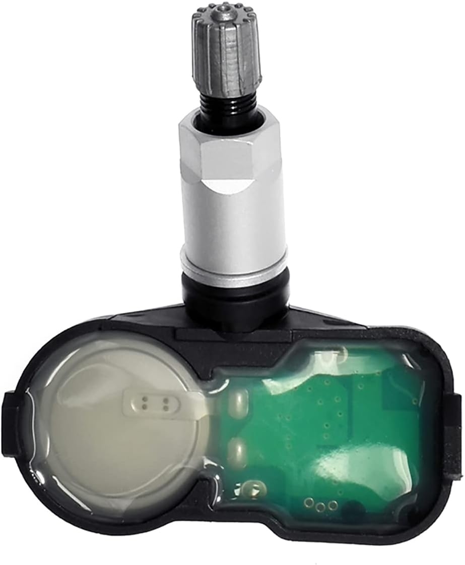

For some reason I can't see the recent reply I sent. Here's a pic of what looks like a battery in it. Not sure if its replaceable.
Sunday, December 31st, 2023 AT 9:30 AM
  • 110,192 POSTS
That is correct. However, that is sealed inside the unit, and (to the best of my knowledge) it isn't replaceable.

I saw some videos of replacing the watch battery 2032, an resoldering it on YouTube, lol I may try it for fun. But if I get that tool that reprograms it to truck an new sensors. Will that fix them? I saw some were for steel rims and others for alloy. My new rims are not steel. Will that factor it?
Sunday, December 31st, 2023 AT 11:09 PM
  • 110,192 POSTS
The tool I have is somewhat expensive, so you may want to have it done when the new wheels are installed. Also, a different wheel shouldn't change how the sensor functions.

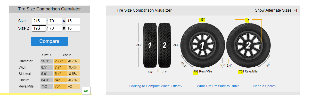

I went to Walmart auto they test TPMS for Free! 3 of my 4 on truck had 0 response a spare measured low battery. I'm looking to change out to 16 inch rims, and may buy new sensors. With factory 15 inch, what size tire on a 16 inch rim can keep the speed an handling at about the same?
Saturday, February 3rd, 2024 AT 6:28 AM
HIDDEN4321
  • 62 POSTS
215/70/15. Currently
Saturday, February 3rd, 2024 AT 6:33 AM
  • 110,192 POSTS
The closest match I can find is a 195 70 16 or a 225 60 16. See pic below.
A 215 65 16 or a 225 60 16 are close as well. They will be a bit wider, and I don't know if they will rub when turning. When I say a bit, it's not much, but I don't want to see you purchase something that may be a problem, even though I don't think it will.
On the other hand, the 195 70 16 has a slightly narrower width. If you go to this site, you can plug in different sizes to see what would likely be the best choice. That is where the pic below is from. Whatever you do, make sure you get a wheel with the proper offset so that doesn't cause issues. Offset is the amount the wheel sits away from or close to the hub where the wheel is mounted.
