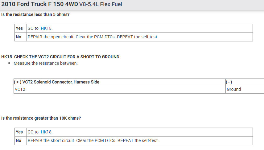

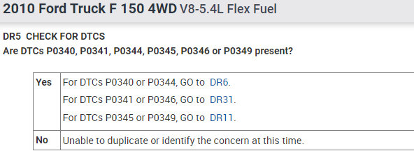

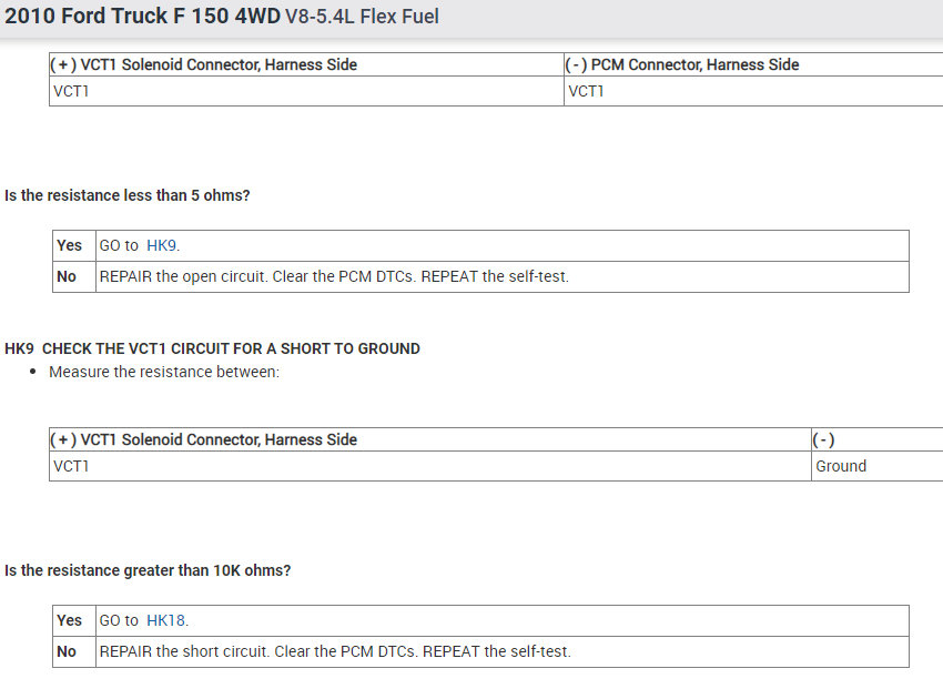

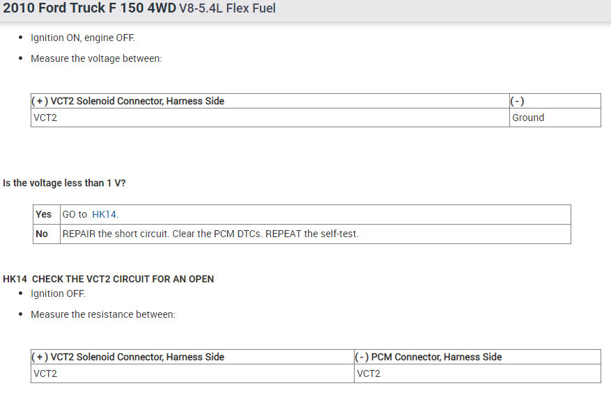

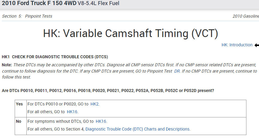

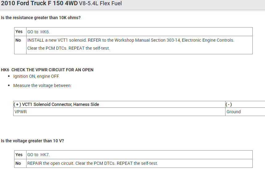

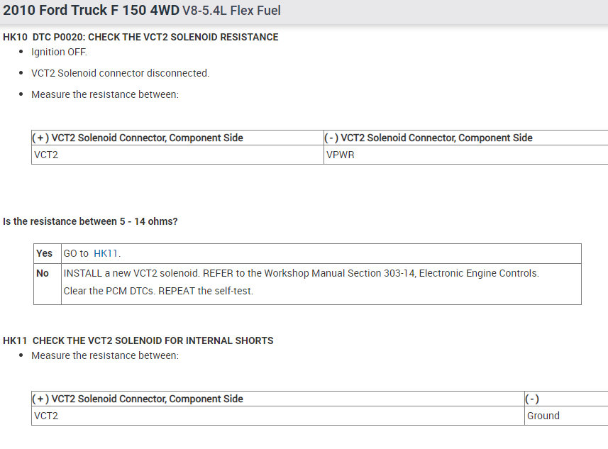

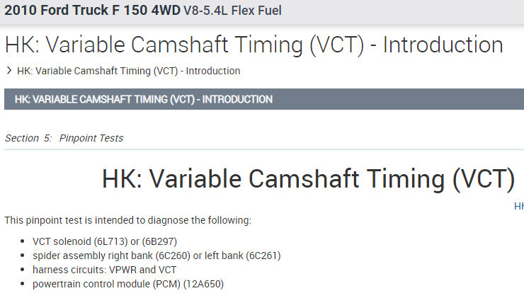

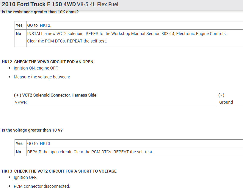

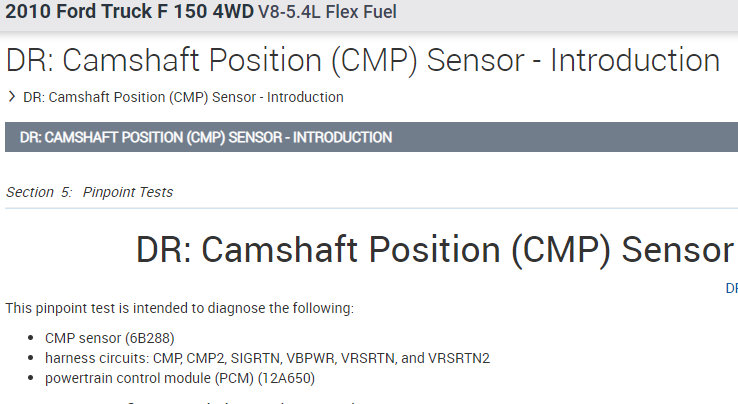

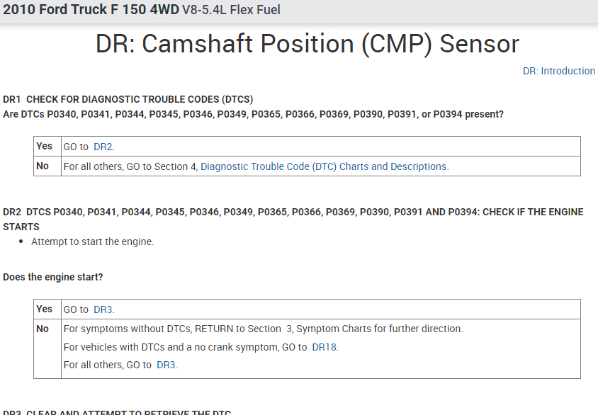

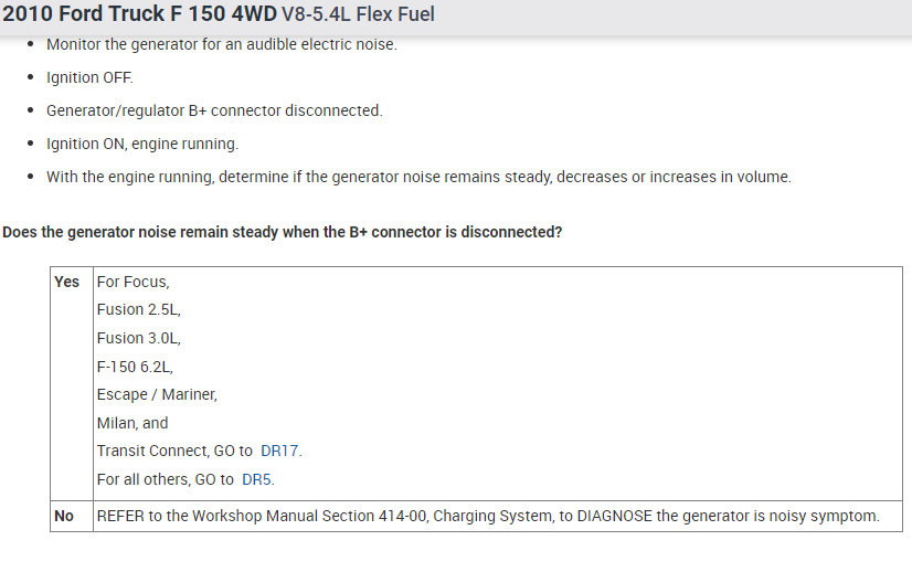

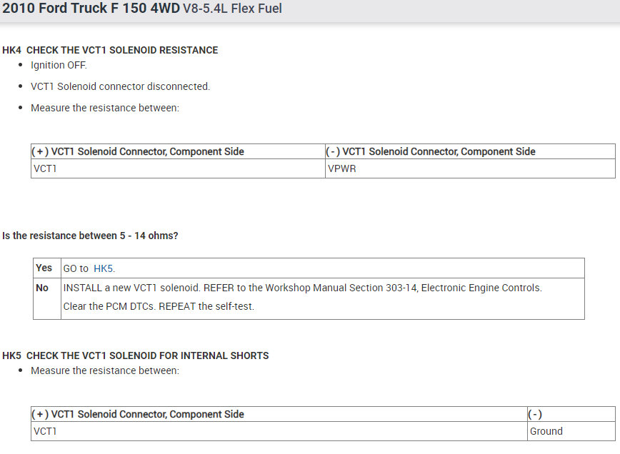

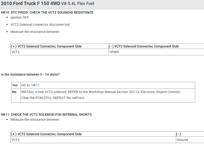

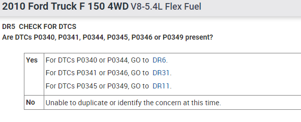

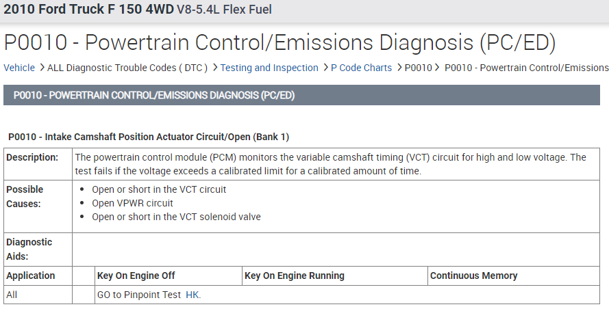

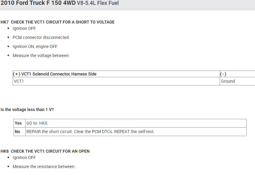

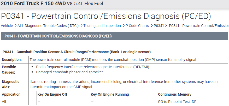

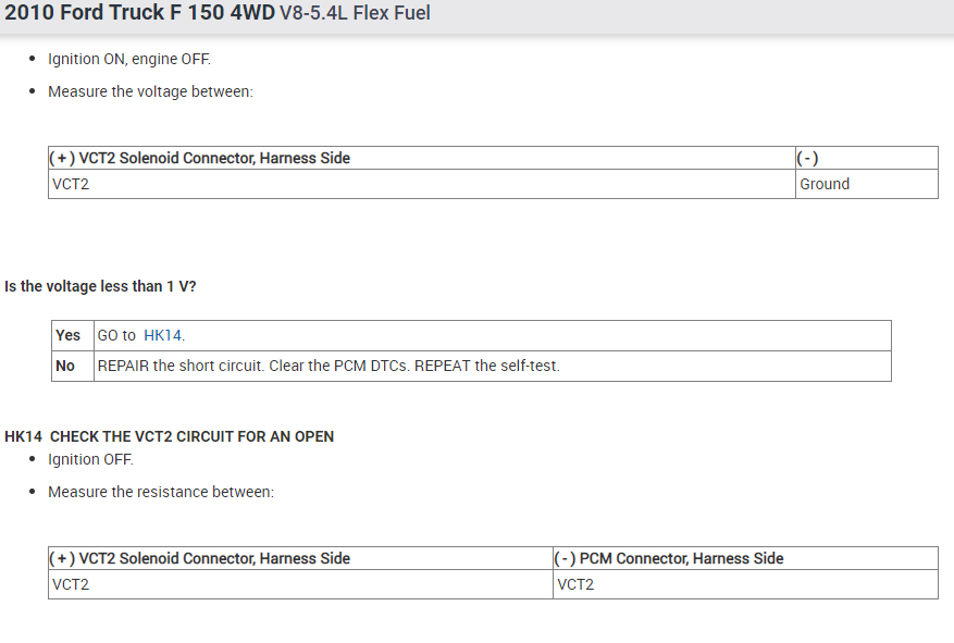

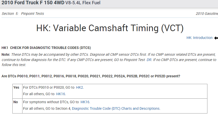

Here are the codes that you have:

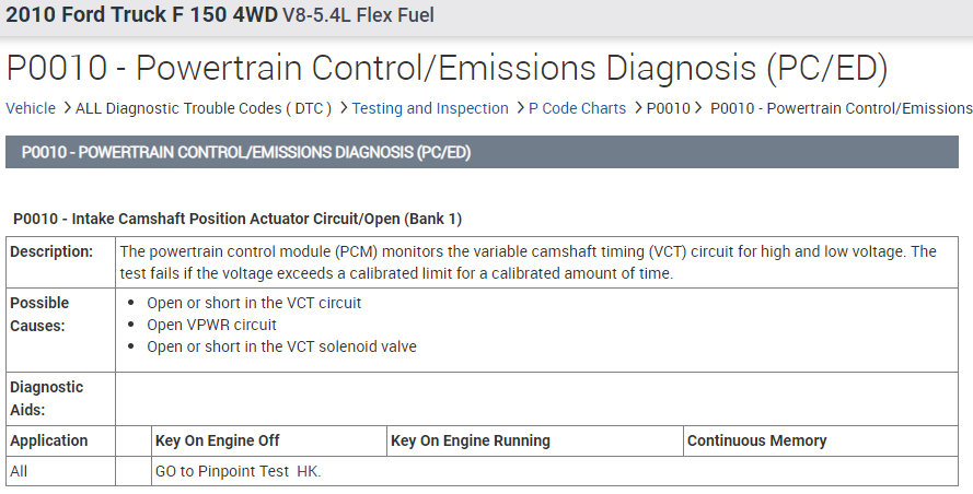

P0010 - Intake Camshaft Position Actuator Circuit/Open (Bank 1)

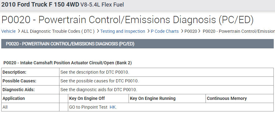

P0020 - Intake Camshaft Position Actuator Circuit/Open (Bank 2)

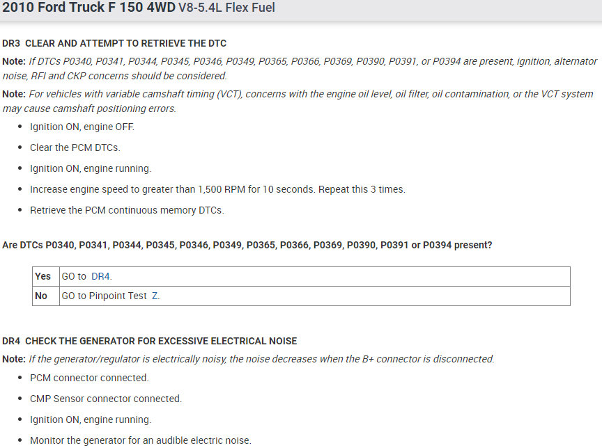

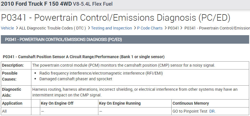

P0341 - Camshaft Position Sensor A Circuit Range/Performance (Bank 1 or single sensor)
Code P0341 can happen for a Radio frequency interference/electromagnetic interference or for a damaged cam phaser and sprocket.

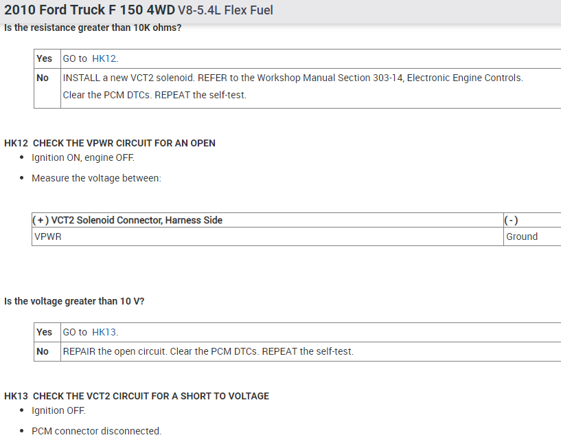

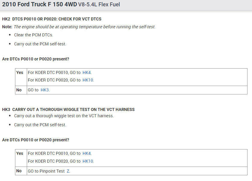

Codes P0010 and P0020 can happen for a open or short in the VCT circuit or solenoid.
I have attached a complete diagnostics flow chart (look below) for you to be able to figure out the issue.
