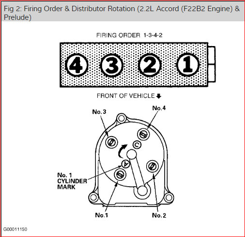

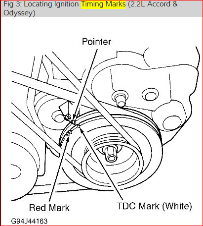

Okay, so I had oil in my spark plug cylinders. I had to change out the valve cover gasket kit. When I reinstalled the rocker arm assembly I think that I may have not checked to see if I moved the crank, but it doesn't run and also does not want to start at all. Any way I can fix the timing would be very appreciated. Thought about just getting a timing gun but I think the cam is just not at the right position. Any help would really be a great Christmas present to me thanks. Okay, so I just stripped everything back down so rocker arm assembly is off so cam shaft is showing. How do I know the crank and cam are at right position to reinstall everything and set timing from distributor?
Monday, December 24th, 2018 AT 4:18 AM
21 Replies
DANNY L
  • 5,648 POSTS

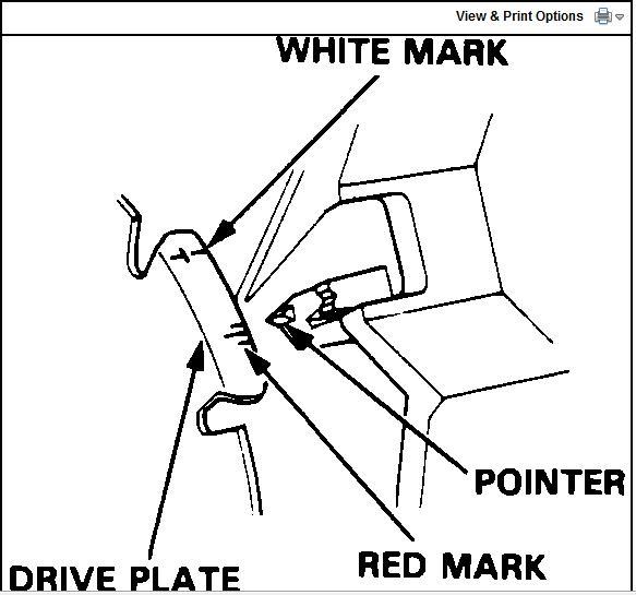

Here is what I found for your Accord. With engine running the ignition timing should be 13-13 degrees before top dead center at 650-750 RPM's. If you were just changing the spark plug tube gaskets on the valve cover I'm just curious as to why you removed rocker arm? I've attached two pictures for a timing reference. Hope this helps and thanks for using 2CarPros.

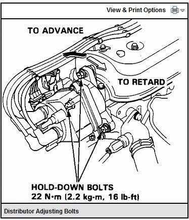

How do I check if the timing is right on my 1996 honda accord and how do I change it if it's wrong. Yes, I have a timing light and I cannot figure out how to adjust the distributor. All I can find on the distributor are 3 anchor bolts that connect it to the engine. Thank you
Monday, January 11th, 2021 AT 4:00 PM (Merged)
KHLOW2008
  • 41,814 POSTS
Loosen the 3 anchor bolts and turning the distributor clockwise would retard the ignition timing. Turning it anticlockwise would advance the ignition timing.
Timing mark is located on crank pulley and the correct timing should be the center mark of the 3 lines ( would be marked Red if the paint is still there).

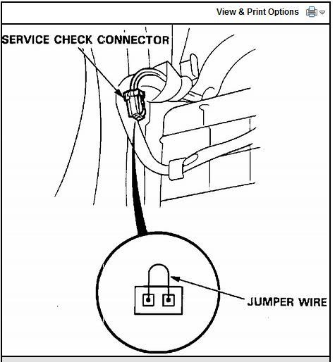

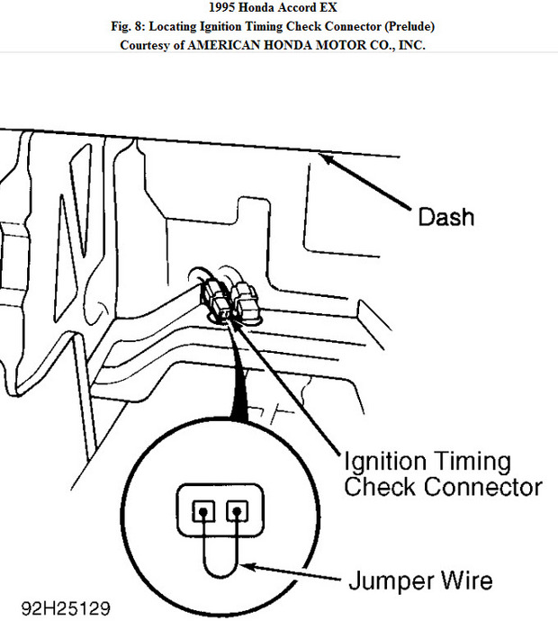

Car failed emissions test and timing is set at 29 btdc
Monday, January 11th, 2021 AT 4:01 PM (Merged)
HMAC300
  • 48,601 POSTS
Timing for 2.2L is 13-17 btdc but yo need a jumper to do this. Same thing for a 2.7L i'm including pic ofr jumper. Best thing to do with this is to change oil and filter, drive for about 15 miles on eway then get it tested, it should pass then.

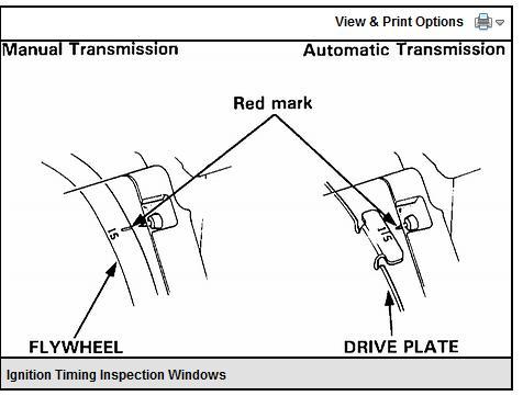

Ever since I had the water pump and timing belt changed on my 93 accord I have ALOT of trouble getting it started was told its prolly my timing. If the timing is off culd it cause the car not to satrt? And where are the timing marks located
Monday, January 11th, 2021 AT 4:02 PM (Merged)
CUP1981
  • 133 POSTS

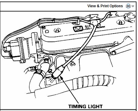

It could be the timing. Question is, has it been like this since the second you had the work done, or did it happen later. If it happened later, chances are that it jumped time. You can attempt to adjust the timing first, following the below procedure. If that doesn't work, you will have to remove and reset or replace the belt. Some techs do not correctly tighten the timing belt tensioner, so you may want to look into that, if you are able to get it back into time. I also attached some images for aid.
1. Remove the rubber cap from the inspection window of the cylinder block.
2. Start the engine and allow it to warm up (cooling fan comes on).
3. Connect the ORN/RED and GRN/WHT terminals of the service connector (BLU) with a jumper wire.
4. Connect a timing light to the No. 1 ignition wire; while the engine idles, point the light toward the pointer on the flywheel (for M/T), or on the drive plate (for A/T).
5. Adjust ignition timing to: 15 +/- 2 BTDC @ 700 +/- 50 RPM
6. Adjust as necessary by loosening the distributor adjusting bolts, and turn the distributor housing counterclockwise to advance the timing or clockwise to retard timing.
7. Tighten the adjusting bolts and recheck the timing.
8. Remove the jumper from the service connector and replace the rubber cap to the inspection window.
+12

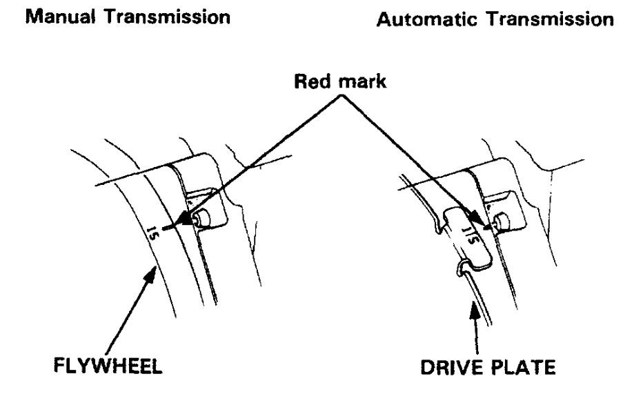

I know that you have to disconnect the vacuum hose to the distributor because it's the fuel injected model, but which timing mark do I place the distributor at? There are three marks and then 1 mark above those. The 3 look like a T.
Monday, January 11th, 2021 AT 4:04 PM (Merged)
Good morning,
I attached the picture of the timing marks for you to view. You will need to use a timing light that can read advance or adjust to show how much advance. Parts stores have them for rent or purchase.
You hook up the light to the battery and number 1 spark plug. Remove the hoses from the vacuum advance and aim the light at the pointer. Adjust the timing light to the solid mark as that is 0. Then read the scale on the light for the timing. Adjust to the specs below.
Fuel-Injected engine:
ALL MODELS: 13-17° BTDC (Red mark), (at 700-800 rpm in neutral).
