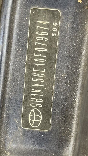

ANDRIN ATEM
  • 398 POSTS
Here is the VIn, maybe something more can come. Because I noticed similar engines with different timing mark positions.
