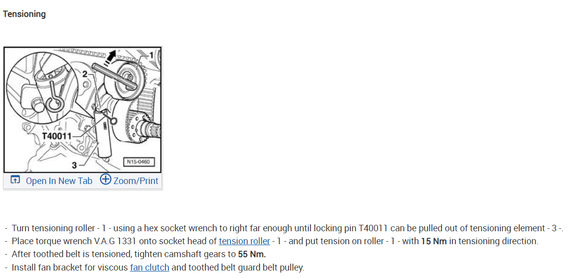

Step by step instructions needed for replacing the timing belt?
2003 VOLKSWAGEN PASSAT
200,000 MILES • 2.8L • V6 • 2WD • MANUAL
PDADDY

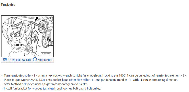

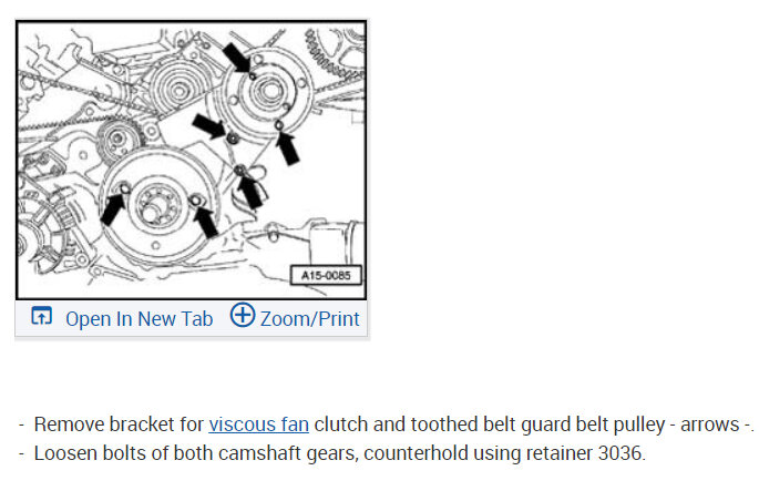

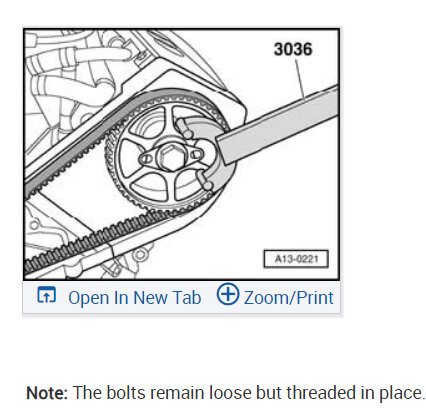

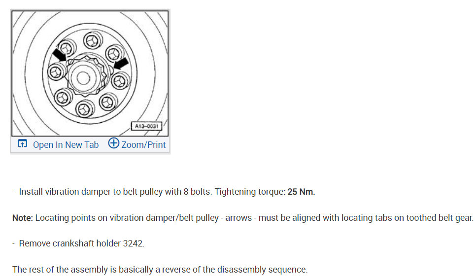

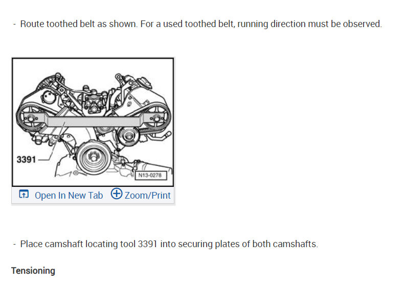

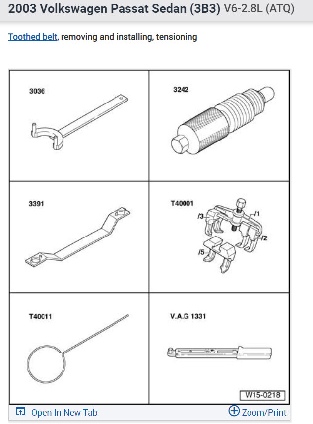

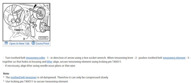

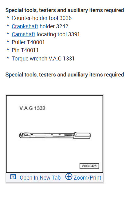

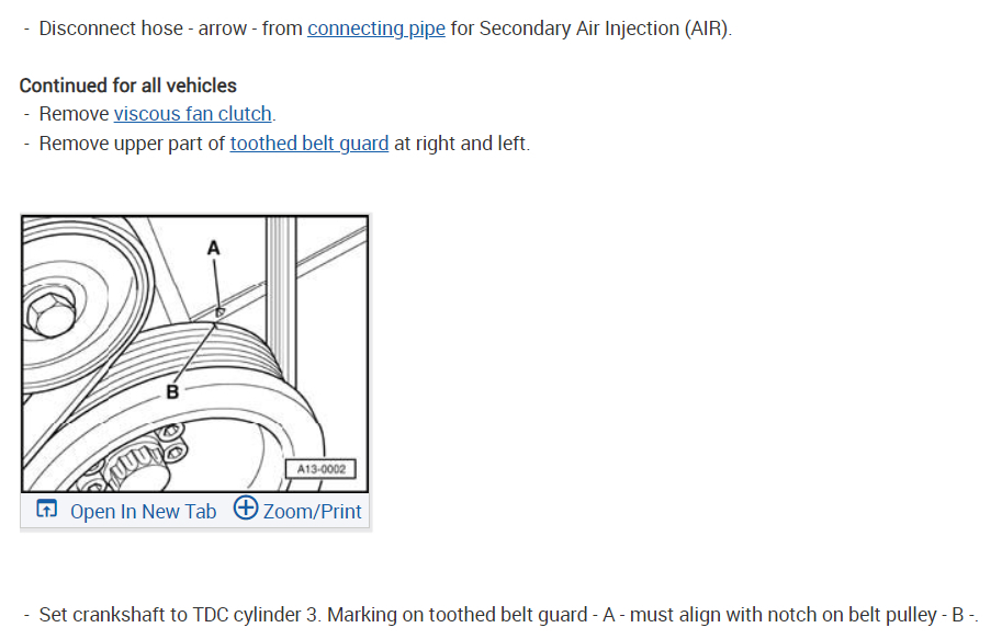

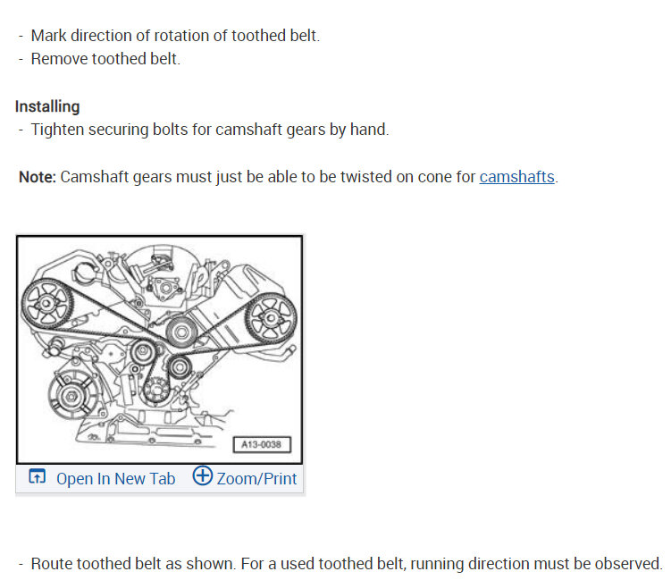

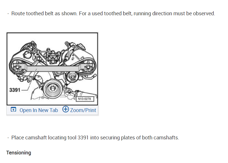

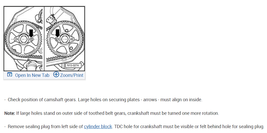

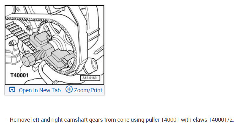

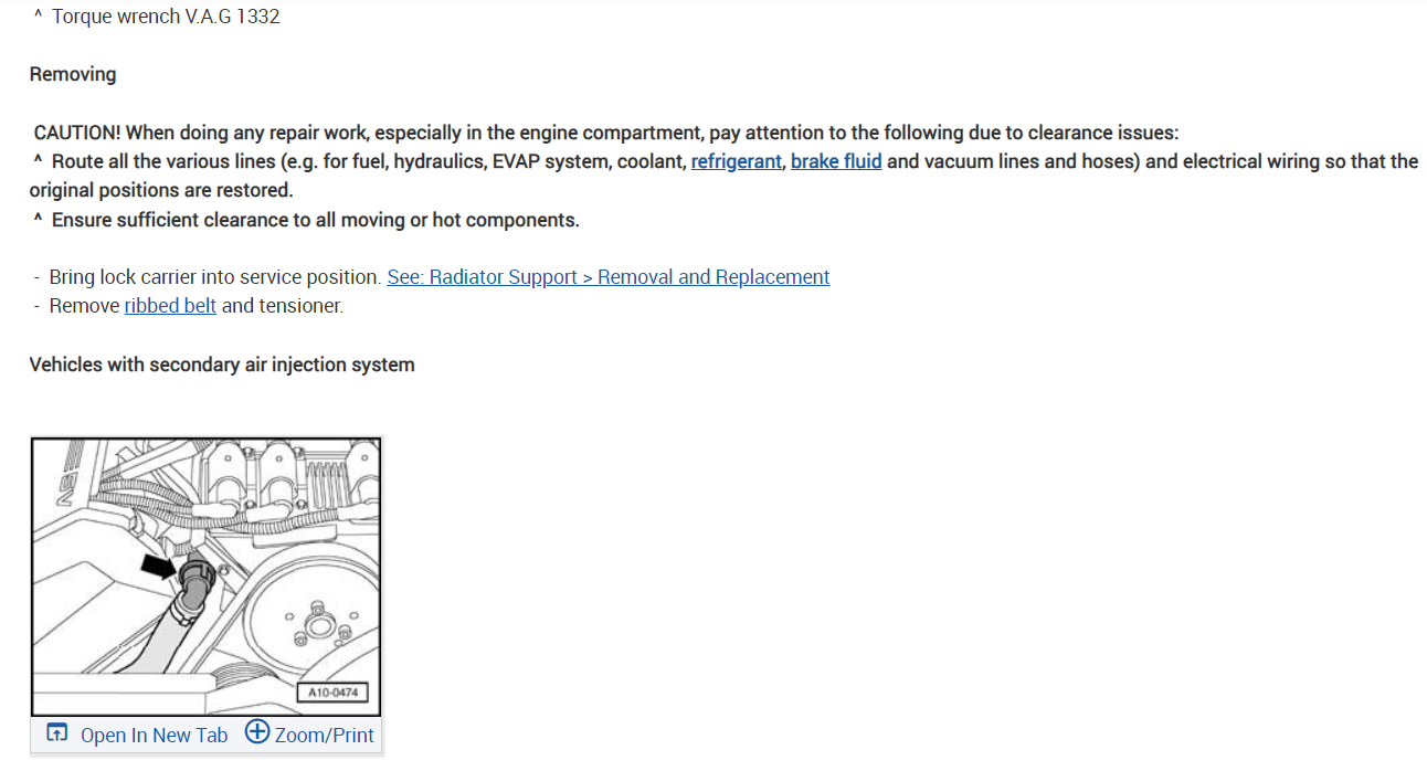

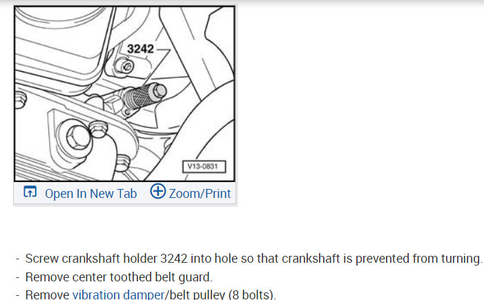

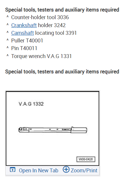

Can you give me schematics and step by step instructions on how to replace timing belt, water pump, and cam seals from the step at service mode on.
Jan 26, 2024 at 7:48 PM
  • 55,319 POSTS
Sure, here you go, these are the instructions on how to replace the timing belt, I did notice there is a timing chain engine model as well so make sure you have the correct application. Start by disconnecting the battery. Check out the images (below). Let us know if you need anything else.
