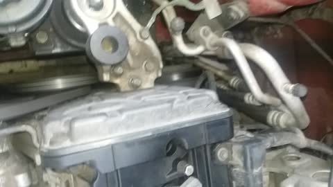

There is a loud squealing sound when I start it and driving
LOU20
  • 2008 KIA RIO
  • 100,000 MILES
I was told that the timing belt was too tight. Do you think that a new timing belt so be put on my car?

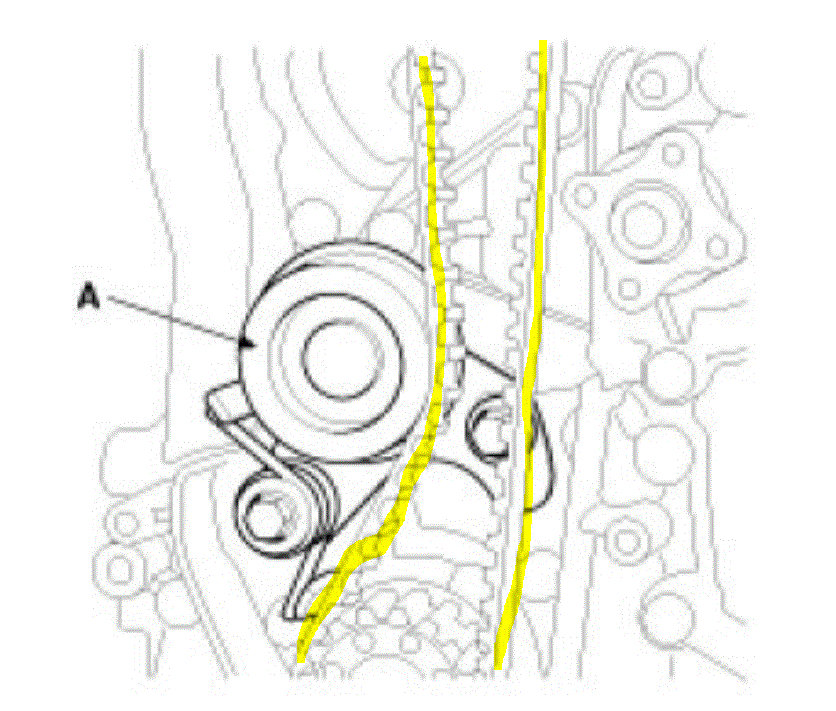

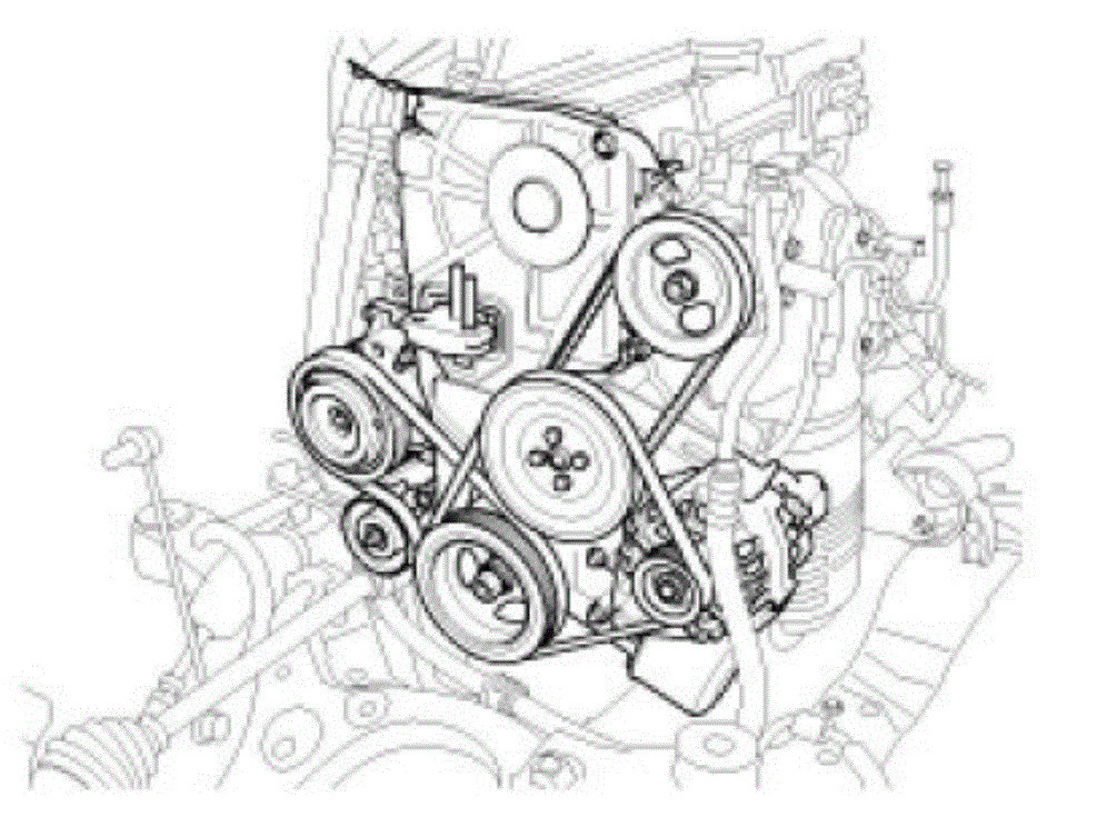

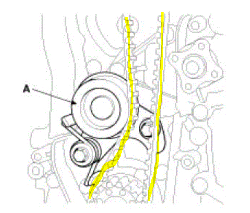

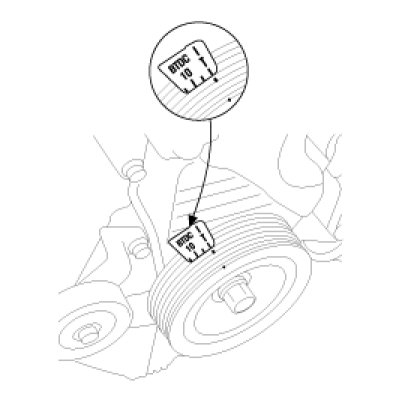

Absolutely not. A timing belt has clogs on it to prevent slipping. If you look at pic one, I highlighted the clogs so you can see them. If that belt slips, the timing will be off and the engine will not run. I'm not saying the belt doesn't need to be replaced based on mileage, but it isn't causing the noise.

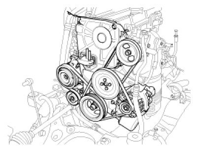

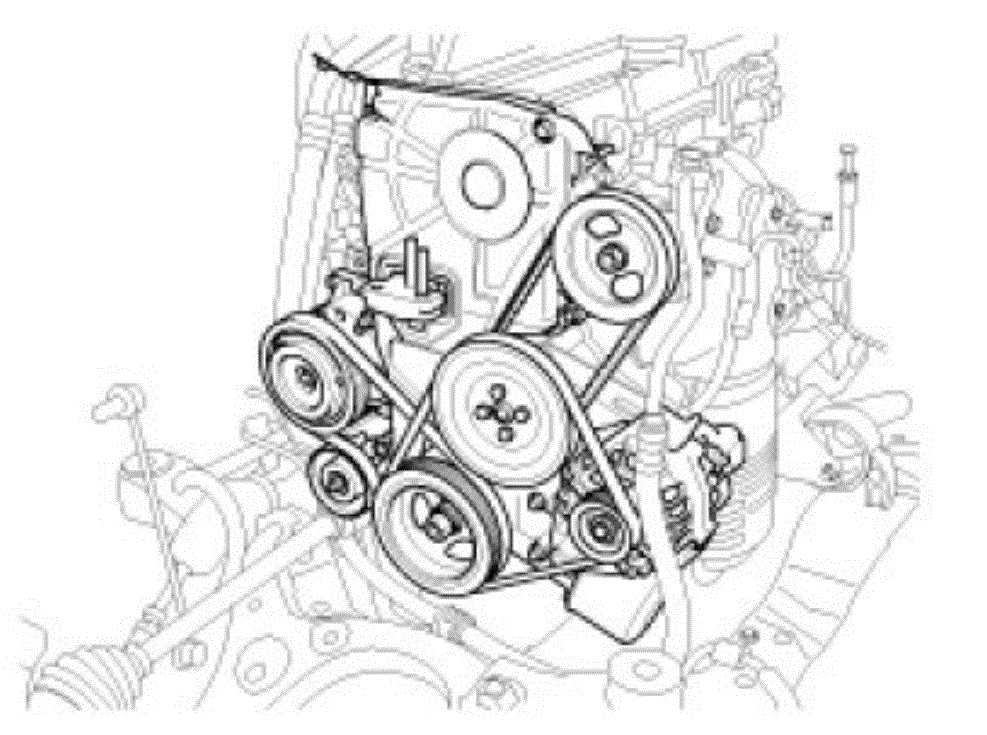

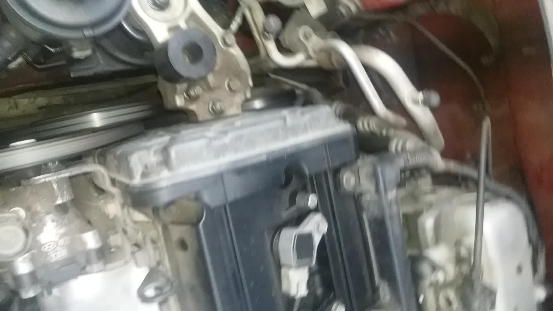

What I think you have happening is one of the accessory drive belts is loose. If you look at pic 2, it shows two belts. These are on the front of the engine. With the engine off, see if they seem loose. If they do, then either the belt needs replaced, adjusted, or the automatic tensioner has failed.
Do me a favor. Inspect the two belts on your vehicle. If you find one loose, copy my second pic, circle the belt that is loose, and send it back to me. I can then direct you for replacement. If I had to guess, it will be the alternator belt, but let's check to be sure.
I hope this helps Let me know if you have other questions.

Interestingly, the timing belt can be adjusted, but I don't know why it would squeal unless the tensioner is seizing. Here are the directions for adjustment. The attached pics correlate with the directions. If you do this or have it done and the timing belt is original, replace it.

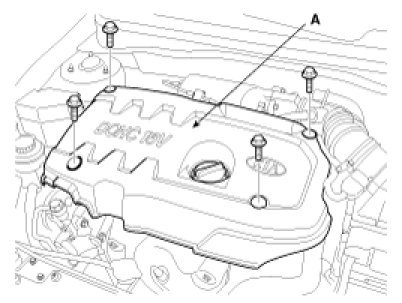

1. Remove the engine cover(A).
Pic 1

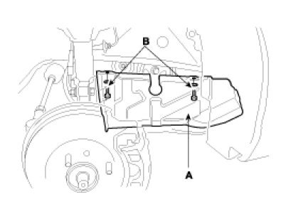

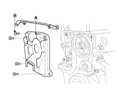

2. Remove the RH front wheel.

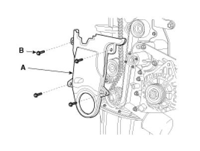

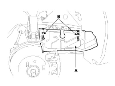

3. Remove the bolts(B) and RH side cover(A).
Pic 2

5. Remove the alternator drive belt(A).
Pic 4
6. Remove the air conditioner compressor drive belt(B).
7. Remove the power steering pump drive belt(C).

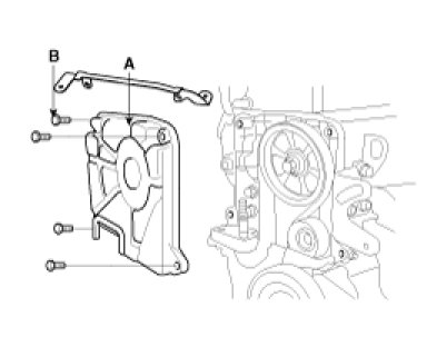

9. Remove the 4 bolts(B) and timing belt upper cover (A).
Pic 5

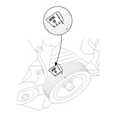

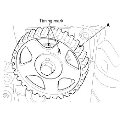

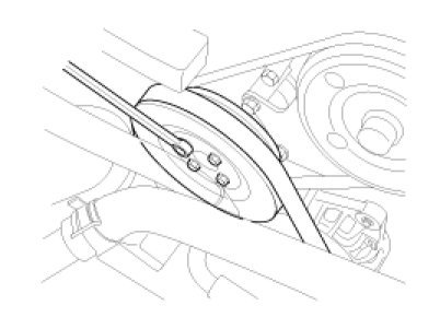

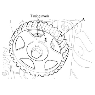

10. Turn the crankshaft pulley, and align its groove with timing mark "T" of the timing belt cover. Check that the timing mark of camshaft sprocket(A) is aligned with the timing mark of cylinder head cover. (No.1 cylinder compression TDC position)
pic 6
pic 7

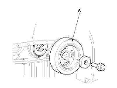

11. Remove the crankshaft pulley(A).
Pic 8

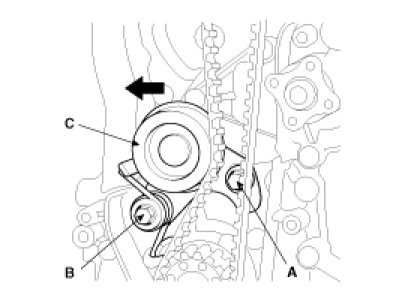

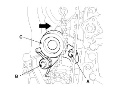

13. Move the tensioner pulley(C) in the direction of the arrow shown after loosen the mounting bolt (A, B).
And temporarily tighten mounting bolt (A, B).
Pic 10

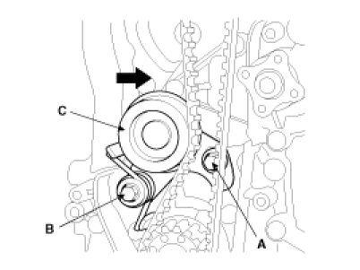

14. Adjust the timing belt tension.
(1)After inspecting the timing belt, replace it if necessary.
(2)Loosen the tensioner pulley mounting bolt and apply tension to the timing belt.
Pic 11t
(3)After checking the alignment between each sprocket and each timing belt tooth, tighten the mounting bolt (A) and (B) one by one.

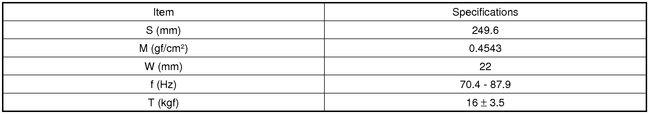

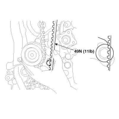

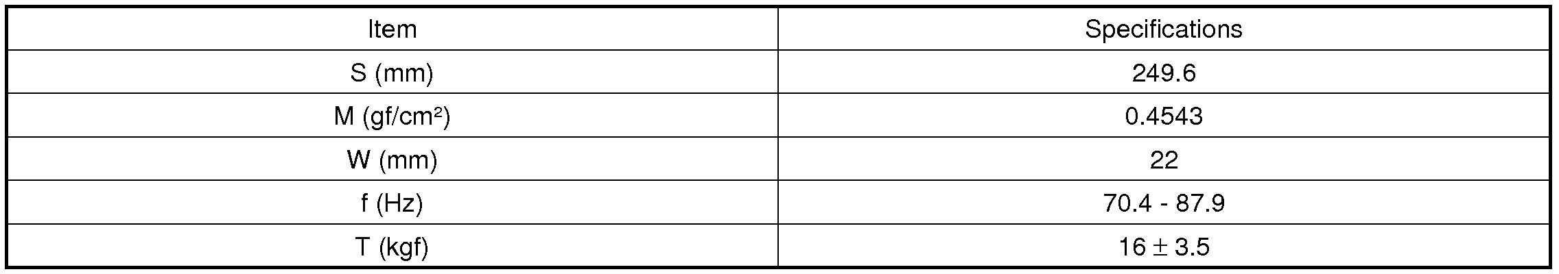

Verify that when the tensioner and the tension side of the timing belt are pushed in horizontally with a moderate force [approx. 49N (11lb)], the timing belt cog end is approx. 1/2 of the tensioner mounting bolt head radius (across flats) away from the bolt head center.
Pic 12
(5)Timing belt tension measuring procedure (by a sonic tension gauge)
Rotate crankshaft in clockwise direction to set 1st piston on top dead center (TDC) and rotate crankshaft in counterclockwise to 90° then measure the belt tension in the middle of tension side span (in arrow direction of above illustration) by free vibration method.
CAUTION:
Avoid rotating the crankshaft in a counter clock wise direction.
Engine damage could occur.
Conversion equation of frequency into tension :
T = (4 / 9.8) x S2 x M x W x f2 / 100000000
S: Measured belt span (mm)
M: Unit weight of belt (kgf/cm2)
W: Belt width (mm)
f: Transverse natural frequency of belt (Hz)
Timing Belt Specifications
pic 13

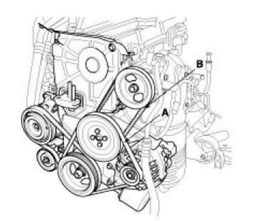

The timing belt has teeth on it and can't slip. So, chances are it is one of the accessory drive belts. Looking at the manual, there could be up to three belts on this vehicle. See pic below. Let me know if that is what you have.
Also, let me know if there is anything that causes or stops the noise. For example, you hear it when the AC is turned on. Or, you hear it when making a sharp turn.
If it is possible, record it and upload it for me to hear.
See pic below.

No check engine light comes on at all. The vibration when i'm driving just started 3 weeks ago, I thought maybe bad gas but don't know. With the A/C on or off the noise still there. When I drive at a higher speed it gets louder. I been trying to figure this out for a year now. Do you think my car would still be running if the timing belt needed adjustment and this issue been a year?
Thursday, June 17th, 2021 AT 6:27 AM
  • 110,192 POSTS
If it was related to the timing belt, I feel something would have happened within a year. Were you able to record the noise?
