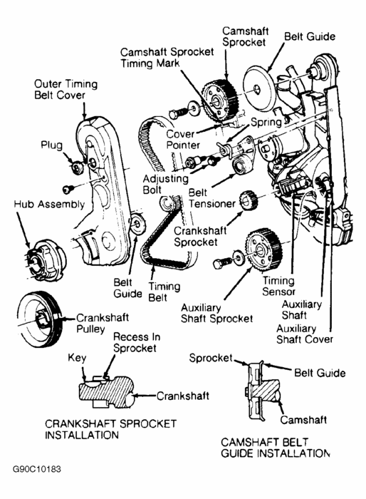

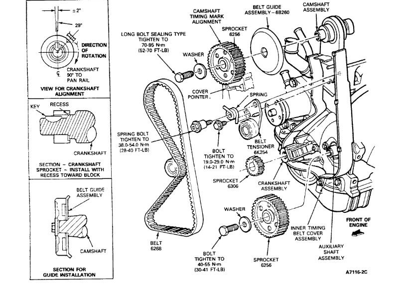

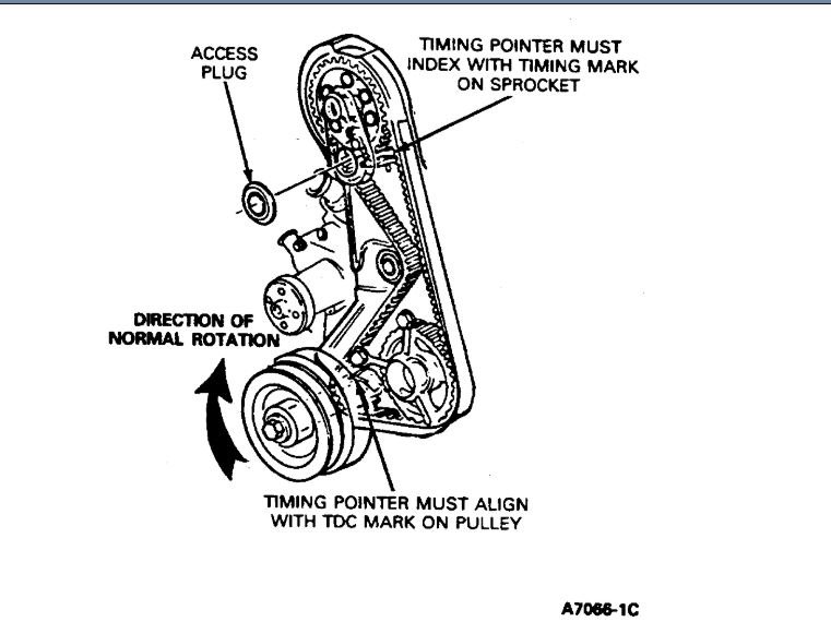

Good evening,
Below are the steps and I will attach pictures for the repair.
This is an easy repair. You can do this yourself.
REMOVAL
1. Open and secure hood.
2. Install protective fender covers.
3. Loosen alternator assembly and remove bolts.
4. Drain cooling system.
5. Disconnect upper radiator hose and position aside.
6. Remove water pump pulley.
7. Remove crankshaft pulley.
8. Remove timing belt outer cover retaining bolt and cover.
9. Loosen belt tensioner pulley assembly.
10. Remove timing belt.

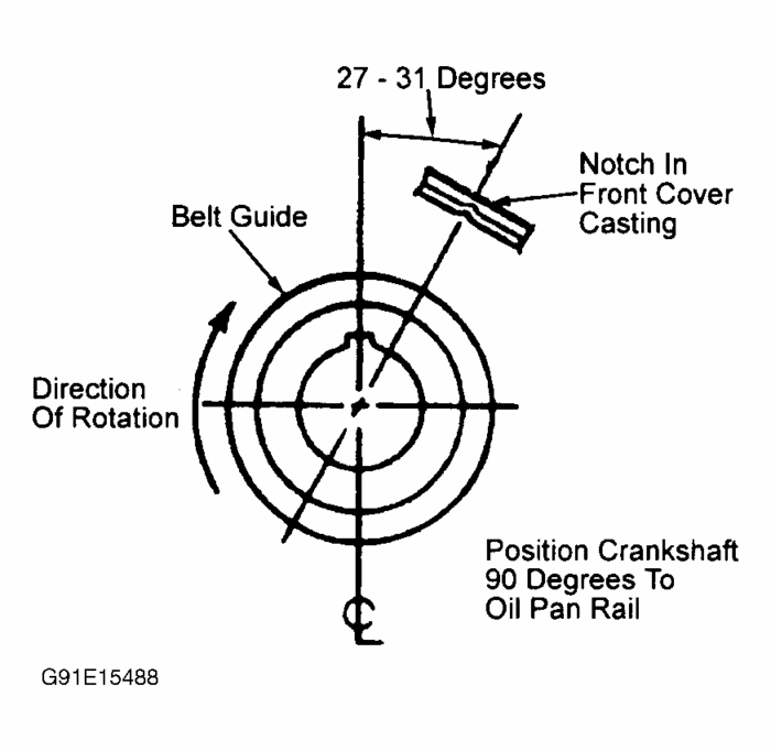

Working on a 1991 ford ranger with a 2.3 liter engine. Can find marks on cam shaft and also crank shaft, can also find timing mark on balance shaft sprocket. But can not find balance shaft mark on engine. Do you have any idea where it might be located?
Wednesday, November 11th, 2020 AT 6:32 PM (Merged)
  • 75,992 POSTS
See below
-1
AVELINO71
On illustration G91E15488 is notch in front cover casting is what I line up the line on the auxiliary shaft sprocket?
-2
  • 75,992 POSTS
You need to put engine no.1 piston on its compression stroke/TDC and then align cam and crank to its markings

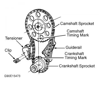

The engine from a 1992 Ford Explorer was put in my 1991 Ford Ranger and it is way out of time. How do I time the motor?
BLUELIGHTNIN6
  • 16,542 POSTS
https://www.2carpros.com/forum/automotive_pictures/261618_Graphic_490.jpg
