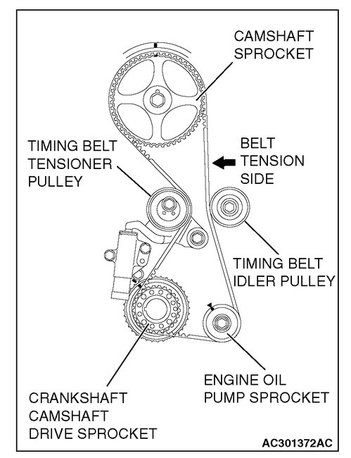

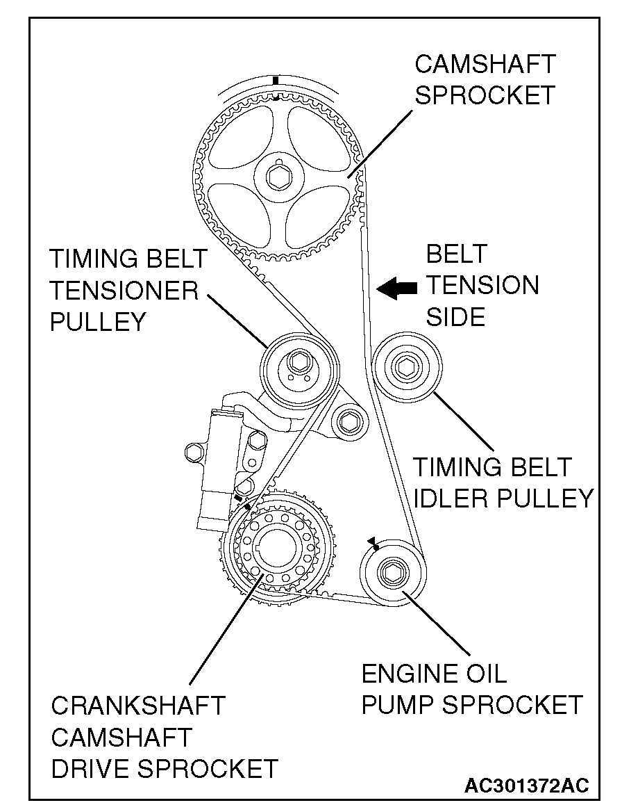

My timing belt and water pump had been replaced about a year ago and everything was fine until a couple months ago. It has a rattle that is annoying when the car is idling or driving. I had it apart again and it is the tensioner. Thank you
Wednesday, January 15th, 2020 AT 4:27 PM
20 Replies
BMDOUBLE
  • 1,139 POSTS
Here is the timing belt timing diagrams. Check out the diagrams (Below). Please let us know if you need anything else to get the problem fixed.

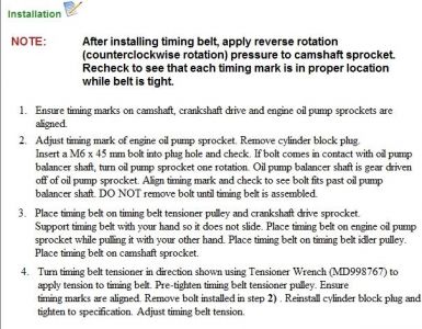

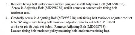

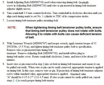

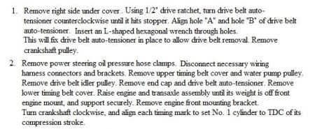

How do I change my timing belt and idlers and pullys
Monday, September 7th, 2020 AT 11:33 AM (Merged)
BLUELIGHTNIN6
  • 16,542 POSTS
https://www.2carpros.com/forum/automotive_pictures/261618_Noname_2486.jpg
https://www.2carpros.com/forum/automotive_pictures/261618_Noname2_812.jpg
https://www.2carpros.com/forum/automotive_pictures/261618_Noname3_296.jpg
https://www.2carpros.com/forum/automotive_pictures/261618_Noname4_138.jpg
https://www.2carpros.com/forum/automotive_pictures/261618_Noname5_59.jpg
