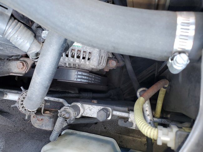

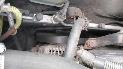

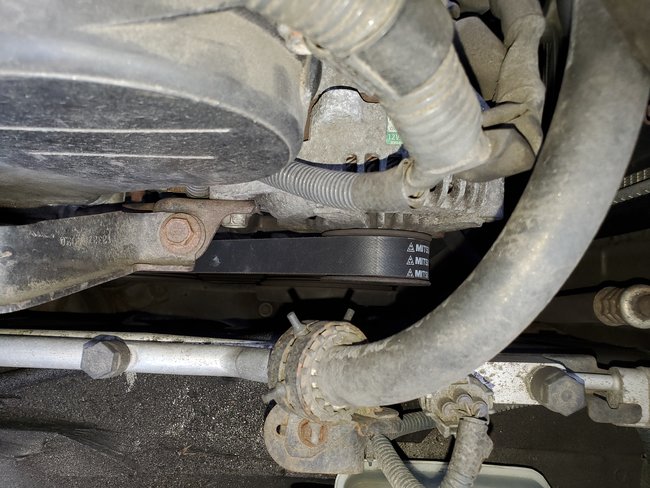

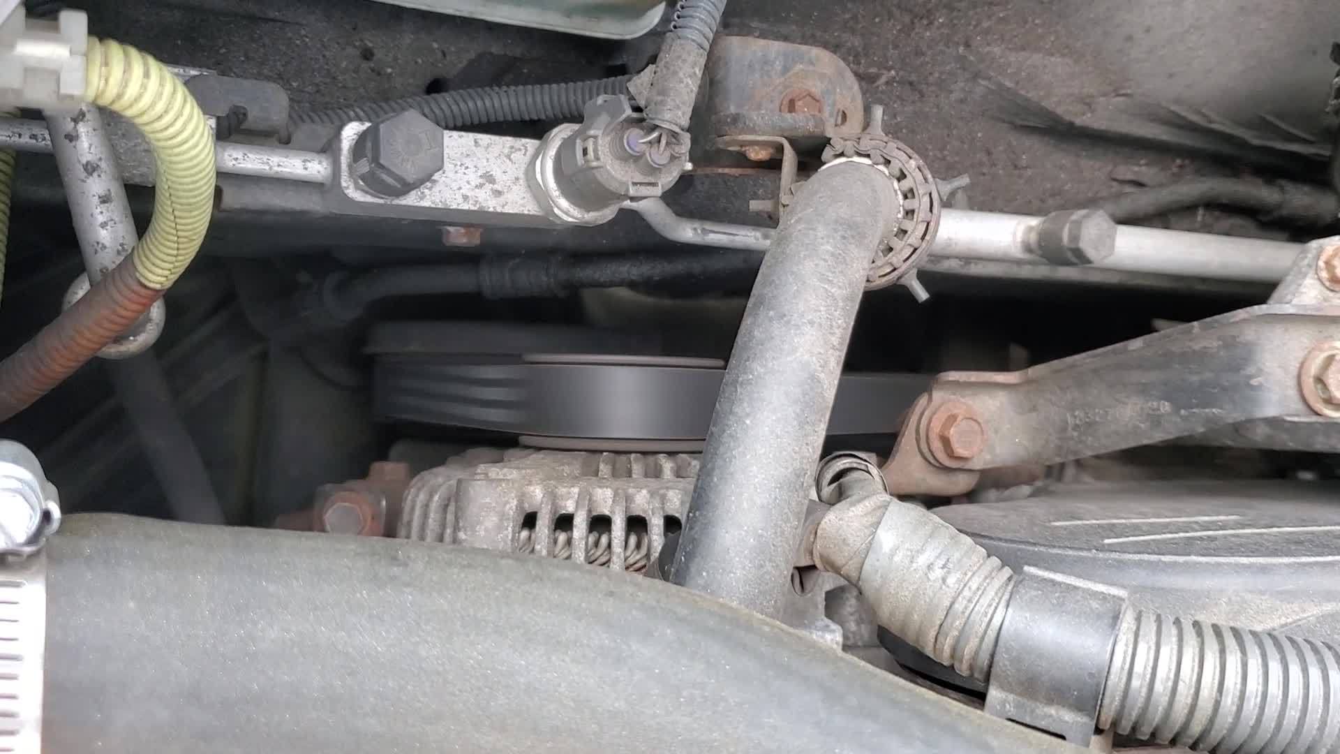

I have some videos and pics of my timing belt. Do you think I need to replace it?
Friday, October 8th, 2021 AT 1:54 PM
8 Replies

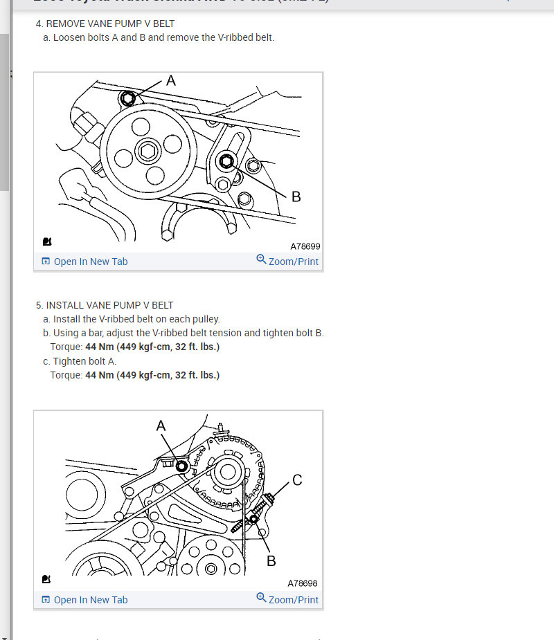

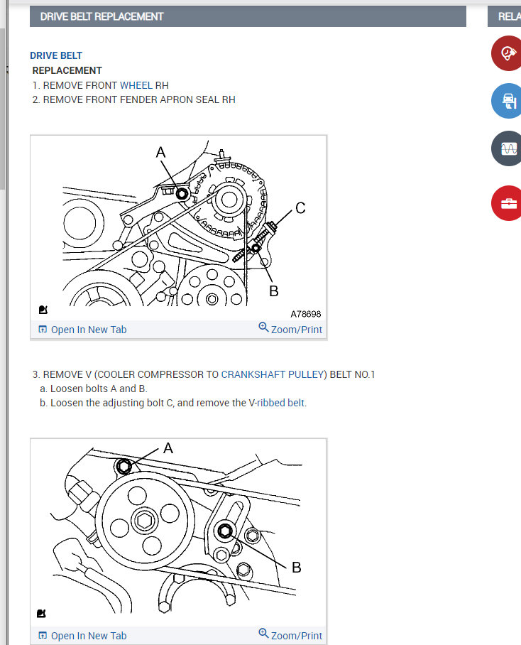

This is known as a drive belt or serpentine belt and only needs to be replaced when it is cracking, making noise, or slipping.
So, if you have not replaced this belt in a while, I would just remove it and inspect the side of the belt with ribs on it and find out if there are cracks in it.
The back side doesn't tell us much, but it looks pretty clean.

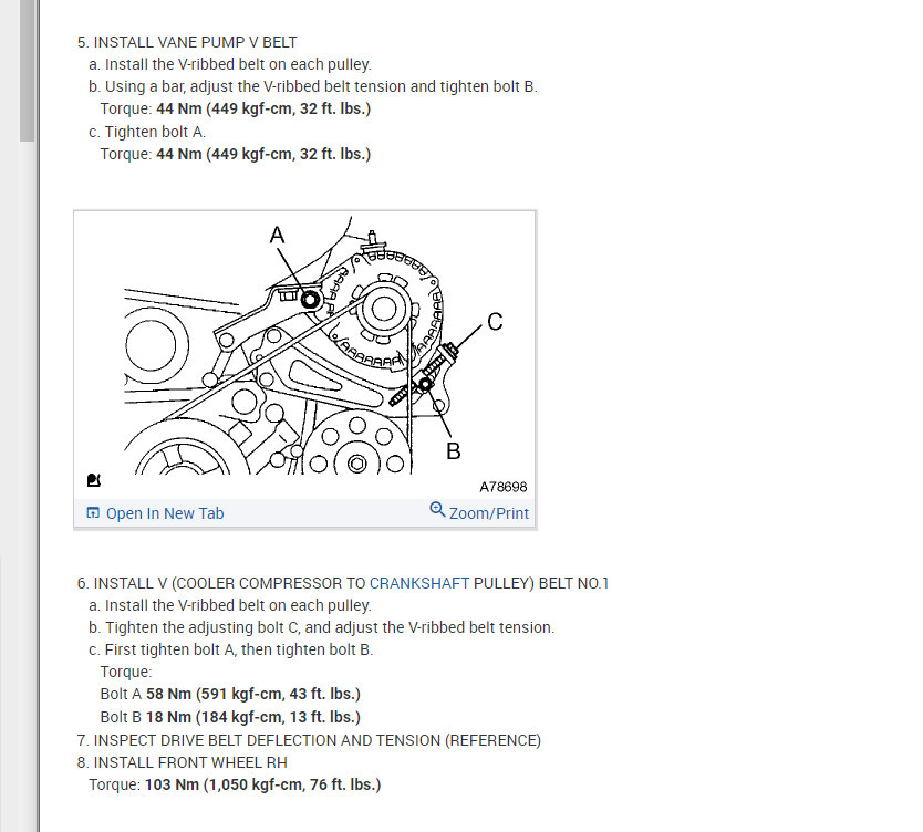

Here is a guide that will help with this:
Below you will find the process from the manual that will help with this.

How about the sound that is making. Is that healthy?
Saturday, October 9th, 2021 AT 2:04 AM
I am sorry. I heard that and meant to mention it. That is the sound or a bearing that is failing.
First thing I would do to confirm it is removing the belt and run the engine for a minute and make sure that grinding/rattling noise is gone.
Then put the belt back on and use a long screwdriver touch it to each pulley (in a safe spot that it won't get caught in the pulley) and then touch your ear to the handle of the screwdriver.
The place that this noise sounds the loudest is the pulley that is failing.

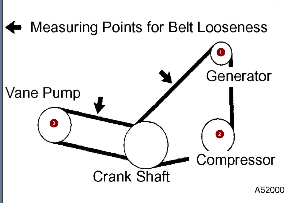

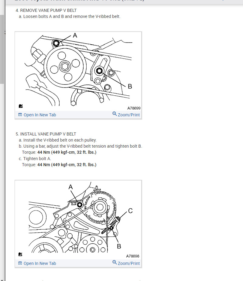

You actually have two belts. One for the alternator and compressor. A second for the power steering pump.
I put a picture of this below. Each of these pulleys have a bearing and we need to listen to each and see where this noise is the loudest.
Also, you need to start with removing the alternator belt and see if the noise goes away. If it does not, then the power steering pump pulley is the issue.
If it does not go away, then your alternator is most likely the issue, but it could be the compressor which is why we need to test it as described.
