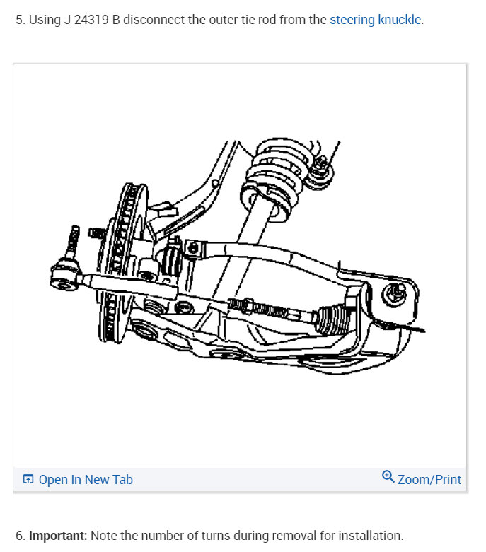

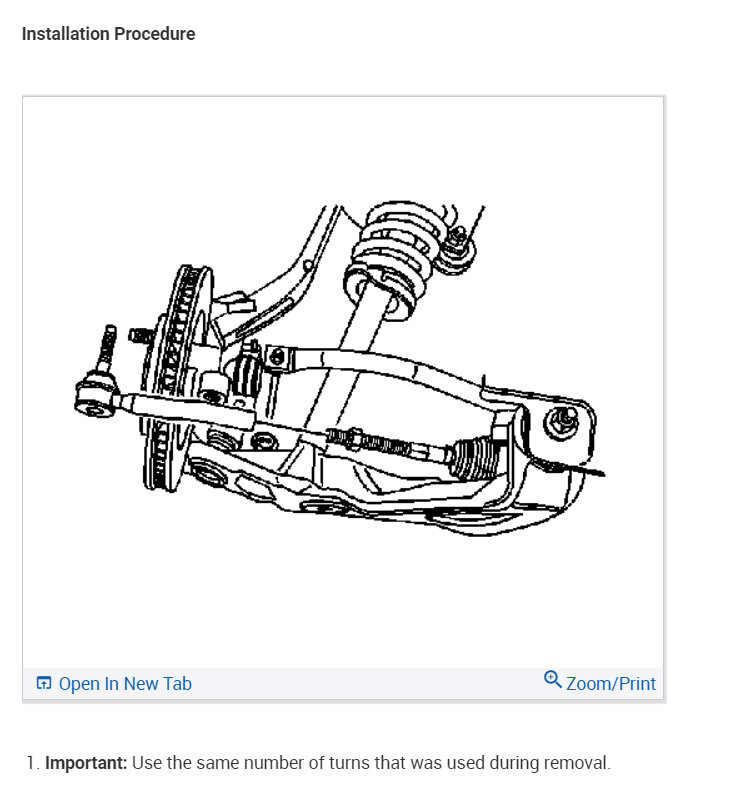

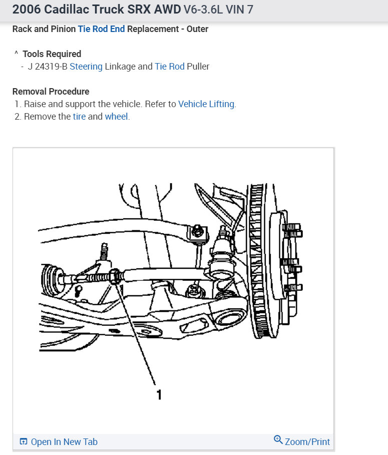

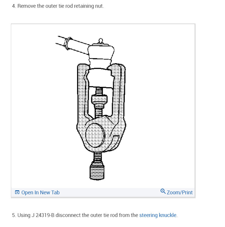

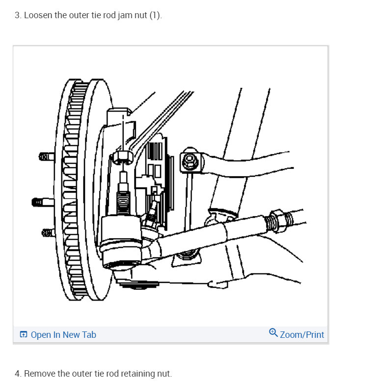

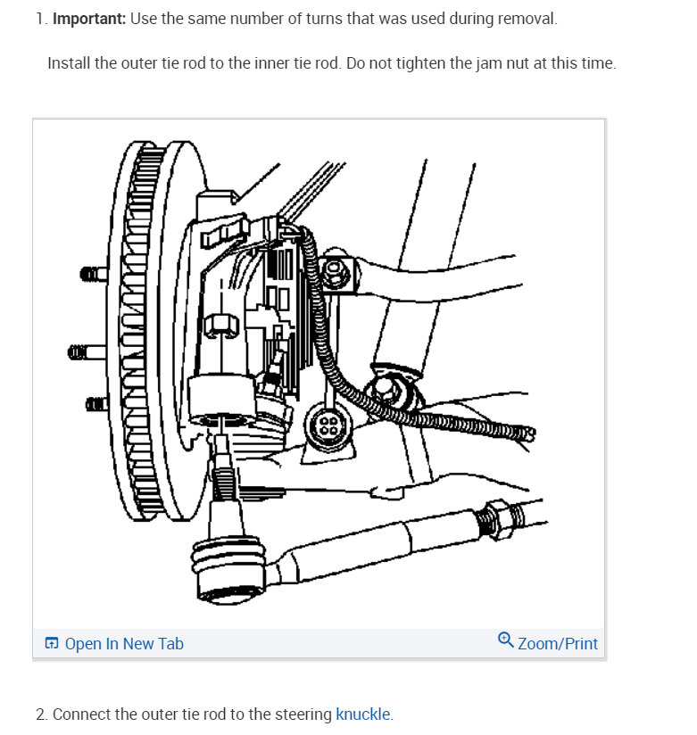

Yep, they only show the outer tie rod being replaced and don't say anything about the inner the outer tie rod replacement instructions are below for clarification. Check out the images (below). I wish we could be more help; I will ask other experts to join in to see if they can contribute.

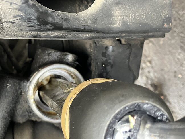

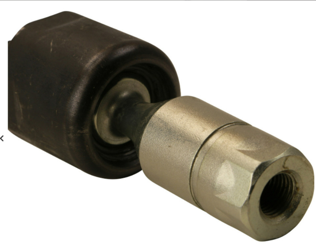

Okay. So, I’ve removed the outer tire rod now coming to the inner tire rod. There is some kind of a weird plastic thing. It’s directly behind the inner tire rod and it looks like there’s something possibly plastic up in the steering gear rack. Is that supposed to be there?
Wednesday, March 22nd, 2023 AT 2:31 PM
RAMPRATS6030
  • 16 POSTS
Here’s a little better idea of what’s going on or is the question at hand... Does the yellowish plastic piece belong and up inside the steering rack gear and appears to be something plastic? Is that supposed to be there? The replacement inner tie rods did not come with no plastic thingy, lol.
Wednesday, March 22nd, 2023 AT 2:33 PM

Hi there my fine feathered friends. I can add another dimension to this story. I ran into this same issue at the Chrysler dealership. The reason the inner tie rod procedure is not listed in the service manual is it was not intended to be replaced in the field when the vehicle was still under warranty. I never ran into a bad one in warranty, but if I had, we were supplied with a brand new rack and pinion assembly with both inner tie rod ends and both outer tie rod ends already installed. I did replace a few rack assemblies on the Stratus model for a very slight chirp when changing direction. Those were covered under warranty and a service bulletin for "customer satisfaction". Those racks also came with all four new tie rod ends.
Part of their warranty policy had to do with anything that was replaced under warranty had to restore that system to like new condition. That meant no used or rebuilt parts, and no machining of parts like brake rotors because that would reduce their life expectancy.
They never said the inner tie rods couldn't be replaced separately, but they left that up to the aftermarket suppliers. You might still find torque specs in the service manual, but always defer to those listed on the instruction sheet that comes with the new part.

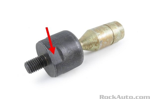

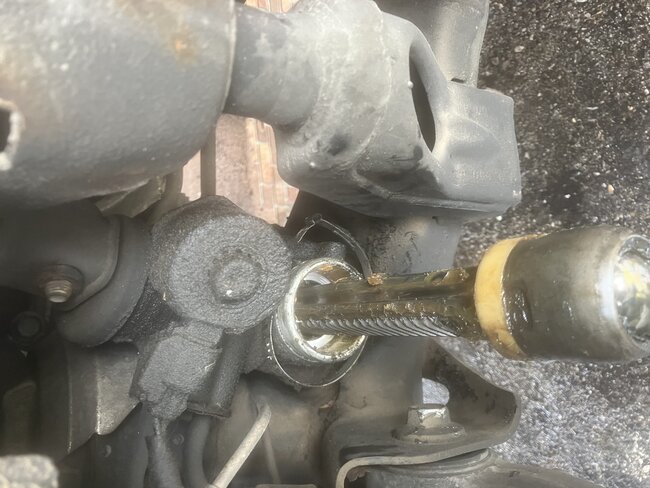

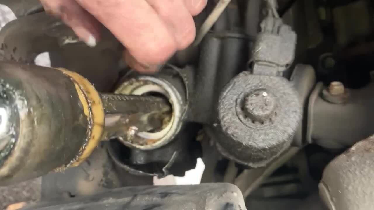

The plastic piece described is often referred to as a "cushion". It slides over the end by my red arrow in the first photo. It softens the metal-to-metal contact when the steering system is turned fully in that direction. Tap that off with a flat-blade screwdriver and small hammer. You can reuse it if it fits. New inner tie rod ends sometimes come with a plastic disc that is slid on first for the same purpose. Don't use both.

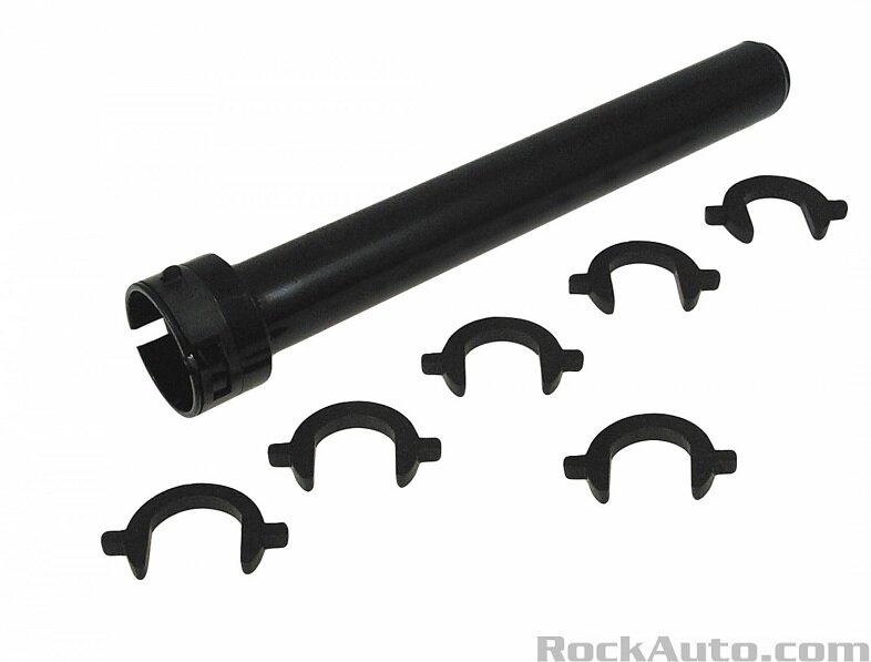

The tool to remove this design is shown in the second photo. Use the crow's foot that fits the two flats on the back side of the joint. Slide the tube over it and run the ears into the two slots on the tool. Swivel the metal ring to hold the wrench in place. Put just a little outward pressure on the tool to keep the wrench on the flats while turning it with a ratchet.
Buy this tool from any auto parts store or any of the tool trucks that show up each week at the repair shops. You can also rent or borrow it from auto parts stores that borrow tools. In my city they make you buy it, then you get a full refund when you take it back. If you choose to keep a tool, you still return it, then they give or order you a brand new one.

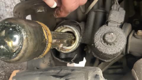

Thank you so much. So I might’ve cranked the driver side down a little bit much on the inner tire rod I done it says 62 pounds foot pressure but that kind of shaved a little bit of that plastic cushion you know not much I just peeled back a little bit. I guess it is the closest side to the rack. My replacement parts from carpros. Com were supposed to include a flat metal washer with the tabs you’ve been down which they seem to forget that my shipment and my new jam nuts that I can’t seem to find any parts store or warehouse. Also, that plastic cushion on the driver's side did not move freely. I can only move it about a quarter of an inch away from the inner tire rod on the passenger side. It moves freely back-and-forth down the shaft and neither one had the metal tabbed washer. Those need to be on there don’t they buy videos I’ve watched I’m saying yes for sure it does but then again I’m pretty sure these tie rods Hartman replaced unless somebody was pretty anal about the metal clamps and stuff like that being exact which is possible very possible so I’m thinking it might’ve came from the factory without those in there but then again, the replacement parts were supposed to have them in there and did not end up inside of like the rack. I can see another like same color, yellow plastic I’ve been there like maybe something broke I’m not quite sure It could be normal. There wasn’t much Fluid inside of the Bello boot whenever I took it apart, I mean, there was some, but not a gaping, a mound or nothing like that I’d say a hefty teaspoon or two worth I will attach some pictures that I took. I’m fixing to go out there and examine the passenger side some more. It was right before dark when I got the driver side together yesterday and got the passenger side off there. I didn’t even look inside the Bello boot. I just popped off the clamps and took it off and seen that plastic piece was free, moving and thought oh man, nothing can ever be the same or match lol. Any input would be much appreciated. I really appreciate your thoughts and your knowledge. I really do because I really don’t have anybody I can turn to, for any kind of mechanical advice.
Sunday, March 26th, 2023 AT 8:26 AM
RAMPRATS6030
  • 16 POSTS

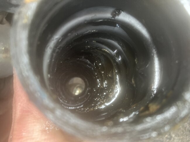

Bellow boot driver side.
Sunday, March 26th, 2023 AT 8:28 AM
RAMPRATS6030
  • 16 POSTS
Mystery plastic piece inside rack.
Sunday, March 26th, 2023 AT 8:29 AM

I got confused reading those really long sentences, but it sounds like lack of experience is the only concern. From what I can see in the photos, it looks like there is some grease or assembly lube in the boot. That can be ignored. If you have power steering fluid that can be poured out, it's time to replace the entire steering gear assembly. With a seal that just recently started to leak, you might find a good half quart of fluid in that one boot. When one seal has been leaking for some time, that boot will fill up, then it will travel to and fill the other boot through the small metal air transfer tube plugged into each boot. At that point there's no way to tell which seal or if both are leaking. Just replace the assembly and let the rebuilder worry about finding and correcting the cause.
I have seen a few places where you can buy seal kits, but repairing these is something we don't do. Years ago a new rack and pinion assembly used to cost around $450.00. You only got a brand new one if the vehicle was under warranty, and then the customer didn't pay for it. As far back as the late '90s, you could buy a professionally-rebuilt rack and pinion assembly with a warranty for less than $150.00. That's a much better value than removing and trying to rebuild an old steering gear yourself. You'll miss or overlook something and end up doing the job a second or third time. Rebuilt rack and pinion assemblies also correct a design flaw that was very common on older GM vehicles.
When you have a thin steel plate with tabs to bend over, those are designed to prevent the part from loosening and unscrewing on its own over time. In this case, the center hole would fit onto the end of the steering gear's shaft only one way so it couldn't rotate, then, once the inner tie rod is screwed on and torqued, the tabs on that plate are bent over the socket of the joint to hold it from turning. Other methods that have been used include an Allen-head set screw and Loc Tite liquid on the threads. Some older designs, mostly on Ford products, used a pressed-in roll pin. Those were supposed to catch on the threads, but only after the tie rod had already unscrewed part way. A special tool was needed to pull those out, but you could easily get them out just by unscrewing the tie rod end. The threads would push those pins out without damaging the threads.
