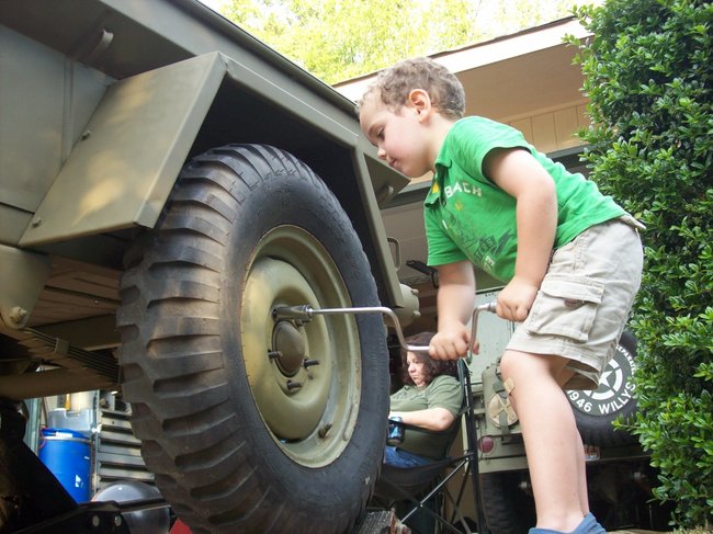

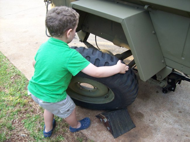

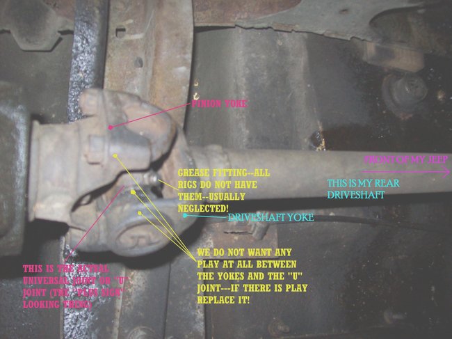

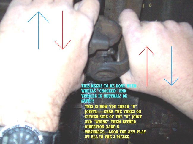

FROM PAST EXPERIENCES WITH MY JEEPS AND OTHER FOLK'S JEEPS
MINE TEND TO SORTA CHIRP WHEN THEY ARE IN THE BEGINNING STAGES OF WORN-OUT-NESS, BUT ONLY WHEN I LET UP OFF OF THE GAS. AS THEY GROW WORSE VIBRATIONS OCCUR, IF IT GETS WORSE THAN THAT, THE YOKES/ PINIONS/ SEALS/ SHAFTS MIGHT GET DAMAGED!
CHECK YOUR UNIVERSAL JOINTS!
I HAVE SOME CRUDE PICTURES OF HOW, WITH MY 1946 WILLYS JEEP AS THE DEMONSTRATOR. SEE BELOW
KEEP US POSTED!

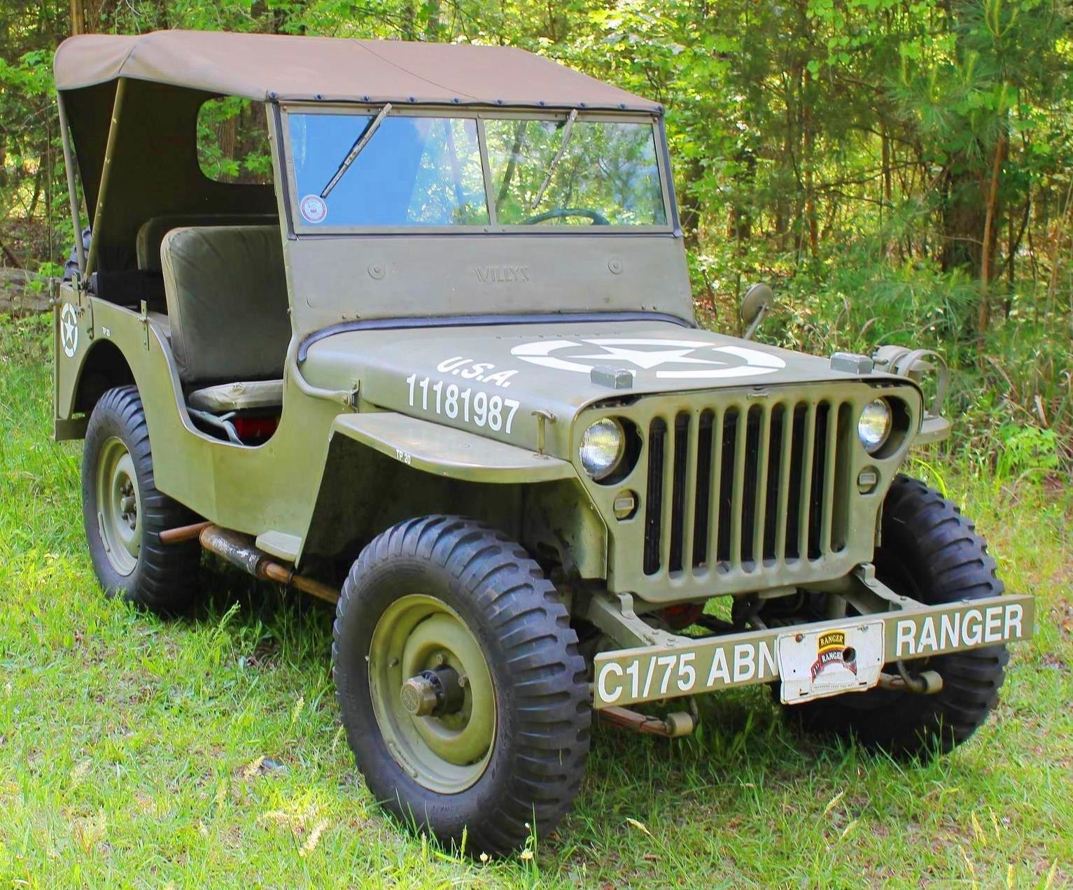

BELOW IS/ WAS MY '79 JEEP #2 (HAD IT FROM '83 TO '87), THE ONE THAT THE TRANNY ANCHOR BOLTS FELL OUT OF!
