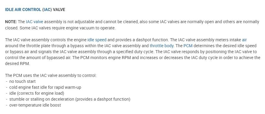

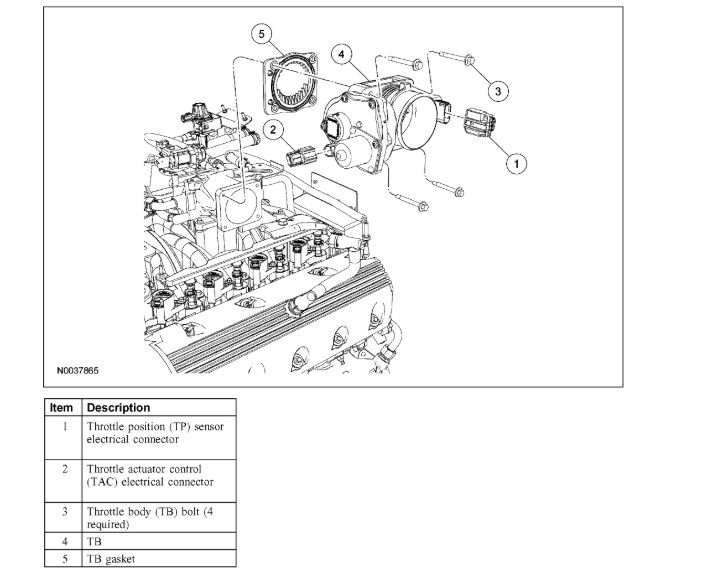

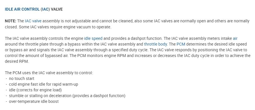

Rough idle, stalls.

Are there any codes set?
There is no relearn for the throttle body itself. It is a plug and play.
Did you replace the throttle body?
