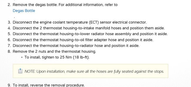

Can you tell me where the thermostat is located on this car?
Wednesday, August 3rd, 2016 AT 7:04 AM
HMAC300
MECHANIC
48,601 POSTS

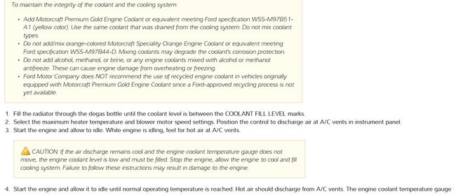

We do not have a picture of that, but you have to remove the degas bottle (overflow bottle) to access it. See pictures for instructions.
