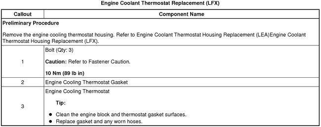

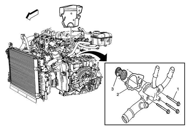

It's sad to say but I can't find the thermostat. Are they in the front back or the side or what?
Mar 16, 2020 at 5:37 PM
  • 110,193 POSTS
Are you referring to the engine cooling system thermostat? If so, look at pictures 1 and 2 for removal and replacement directions and location. Check out the diagrams (Below). Please let us know if you need anything else to get the problem fixed.
