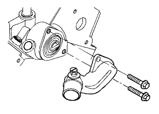

From the diagram in a previous answer it looks as though the Impala's thermostat is located inside of where the radiator hose slips onto part of the manifold that comes from the engine block. If this is correct how do I remove and replace the thermostat?
Thank you in advance.

Yes, as the diagram below shows, there are two bolts needing to be removed from the thermostat housing.

Thank you for all your help. I bought the thermostat and am going to replace it tomorrow. One more question. Is there supposed to be a gasket the goes between the manifold and the engine block or just the rubber round one that is already on the thermostat?
Years ago I replaced one on my 1993 Chevrolet Lumina and I think I remember that car had a gasket that went on the manifold. Just want to make sure I have anything.
Thank you again for all your help.
+1
Tuesday, June 8th, 2021 AT 10:21 AM (Merged)
BLUELIGHTNIN6
  • 16,542 POSTS
The thermostat gasket is the kind of thick round gasket on this vehicle, that is it.

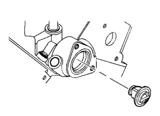

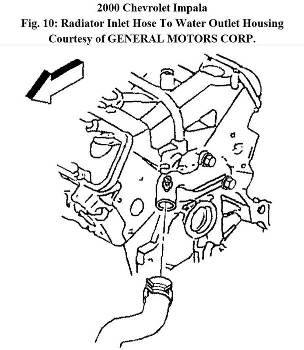

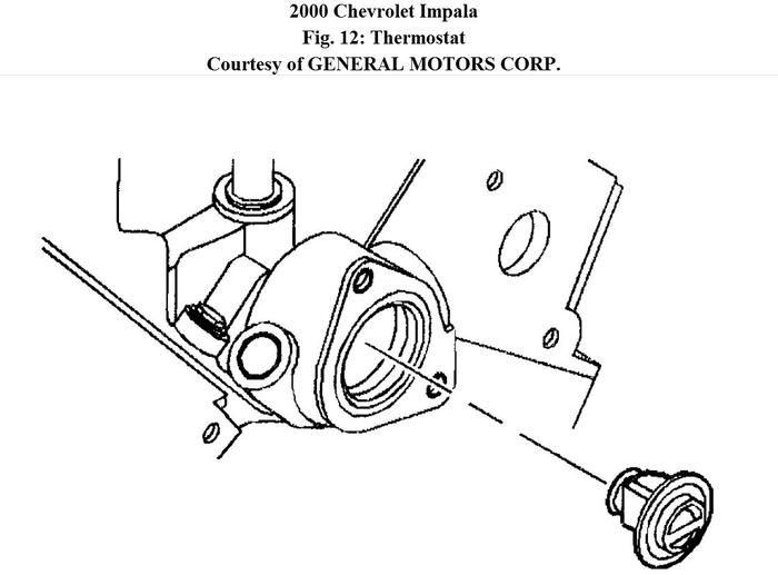

DENNYP
  • 1,823 POSTS
Depends on engine size. Here are your two options.
https://www.2carpros.com/forum/automotive_pictures/102900_70064_1.jpg
https://www.2carpros.com/forum/automotive_pictures/102900_30962_1.jpg
https://www.2carpros.com/forum/automotive_pictures/102900_tstat_1.jpg
The last one is for a 3.8l v6
The first two are for the 3.4l v6

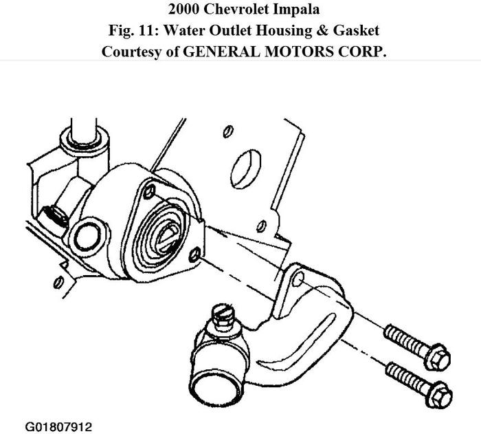

KHLOW2008
  • 41,814 POSTS
THERMOSTAT
Removal
1. Remove the air cleaner intake duct.
2. Partially drain the cooling system.
3. Use the Hose Clamp Pliers (J 38185) to reposition the hose clamp from the water outlet housing.
4. Remove the radiator inlet hose from the water outlet housing.
5. Remove the exhaust crossover pipe.
6. Remove the water outlet housing bolts.
7. Remove the water outlet housing and the gasket.
8. Remove the thermostat.
9. Clean the water outlet mating surfaces.
Installation
1. Install the thermostat.
2. Install the water outlet gasket and housing.
3. Install the water outlet housing bolts. Tighten the bolts to 25 N.M (18 ft lbs).
4. Install the exhaust crossover pipe.
5. Install the radiator inlet hose to the water outlet housing.
6. Use the Hose Clamp Pliers to reposition and install the hose clamp to the water outlet housing.
7. Install the air cleaner intake duct.
8. Fill the cooling system. Refer to COOLING SYSTEM BLEEDING.
