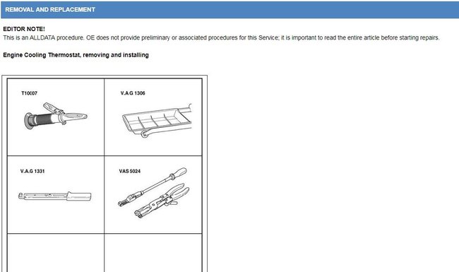

What size thermostat and location?
May 22, 2018 at 11:28 AM
HARRY P
  • 2,292 POSTS
Hello. I am not sure what size you are looking for, but here is a link to a thermostat on eBay that will fit your car: https://www.ebay.com/itm/New-Thermostat-VW-Coupe-Volkswagen-Beetle-Jetta-Passat-Audi-SPL010516-050121113C/251071576597?fits=Make%3AVolkswagen%7CModel%3ABeetle&epid=1579691304&hash=item3a75083a15:g:8QkAAOSwT-9ajtfg

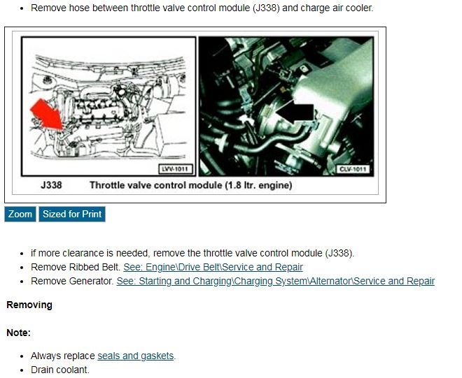

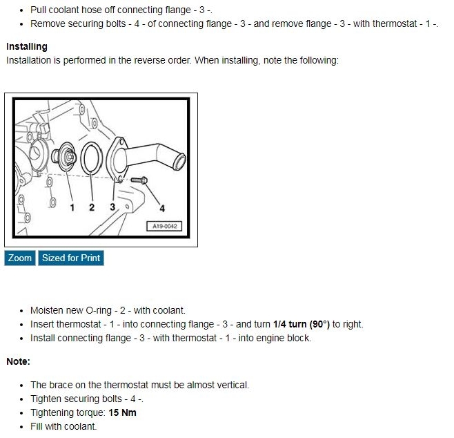

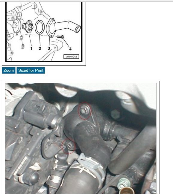

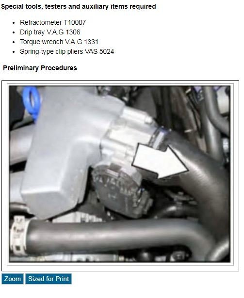

As far as the location goes, Iam attaching AllData's how to guide in the images below. It includes the location.
