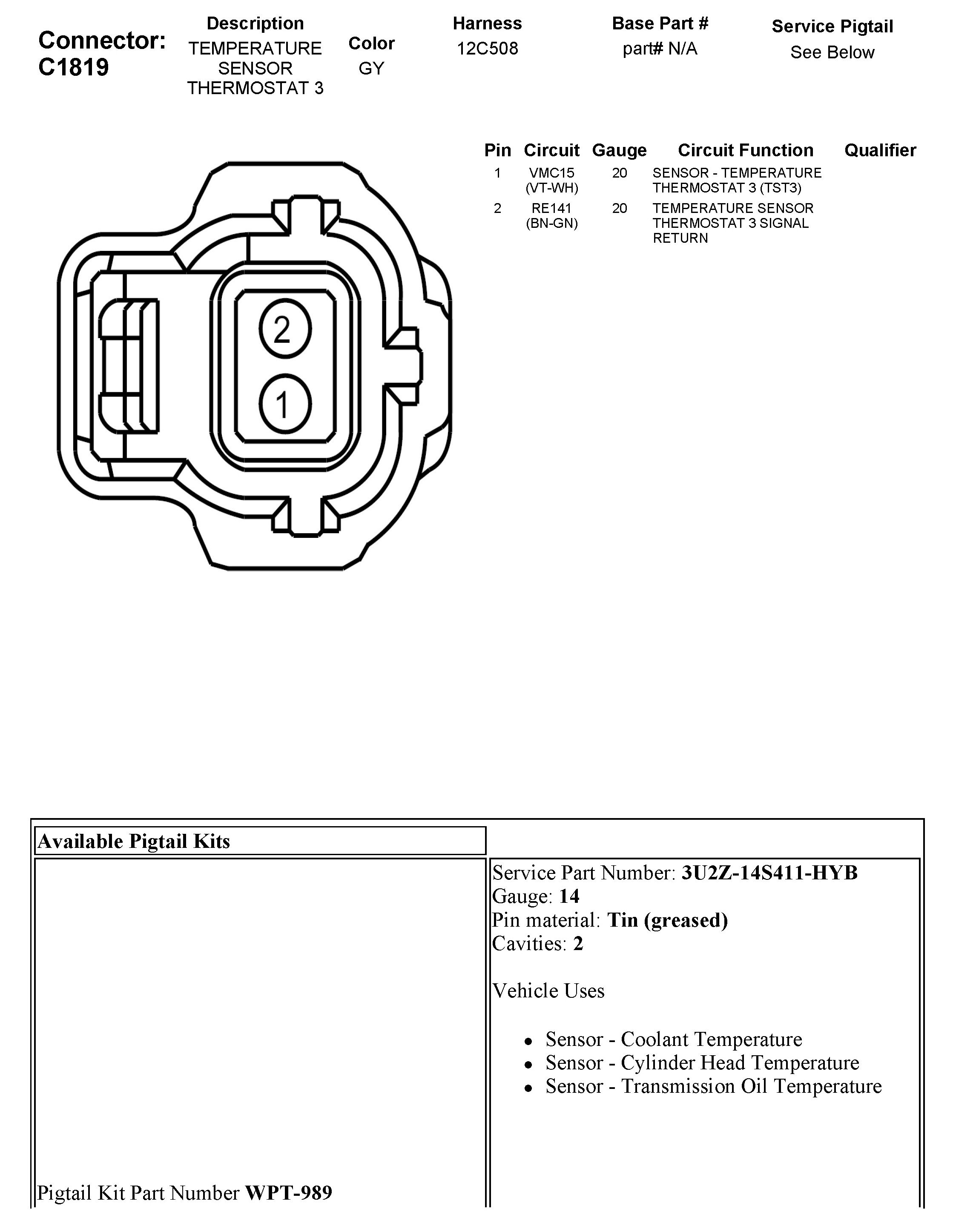

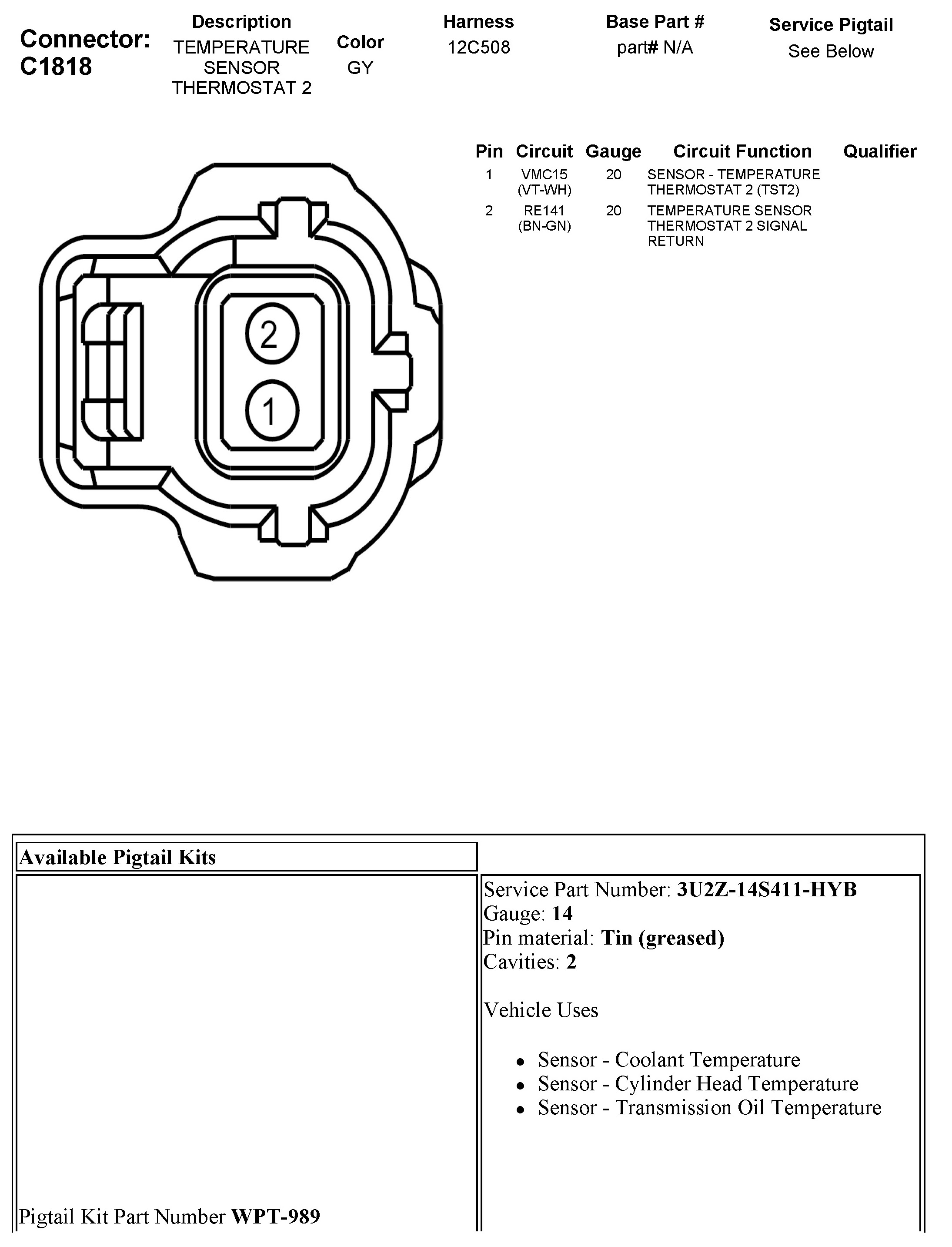

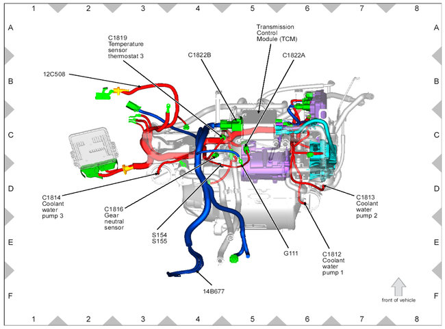

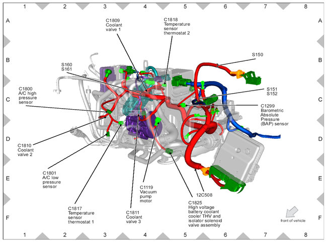

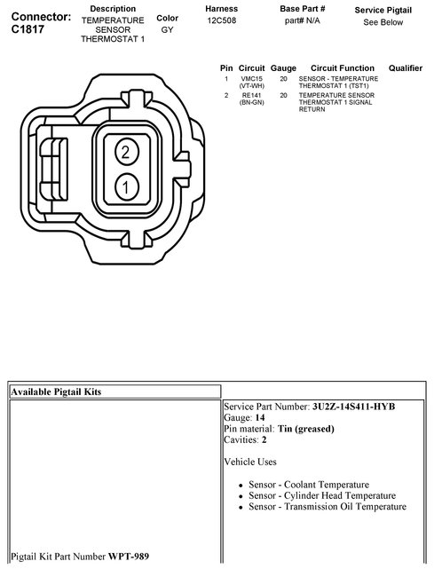

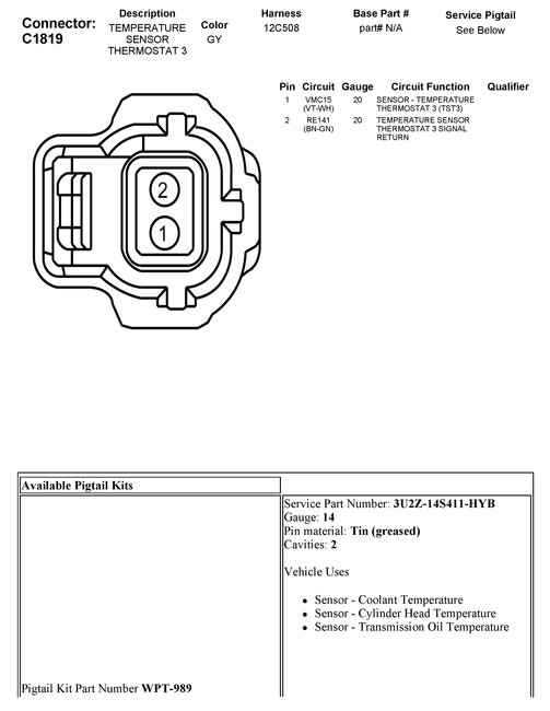

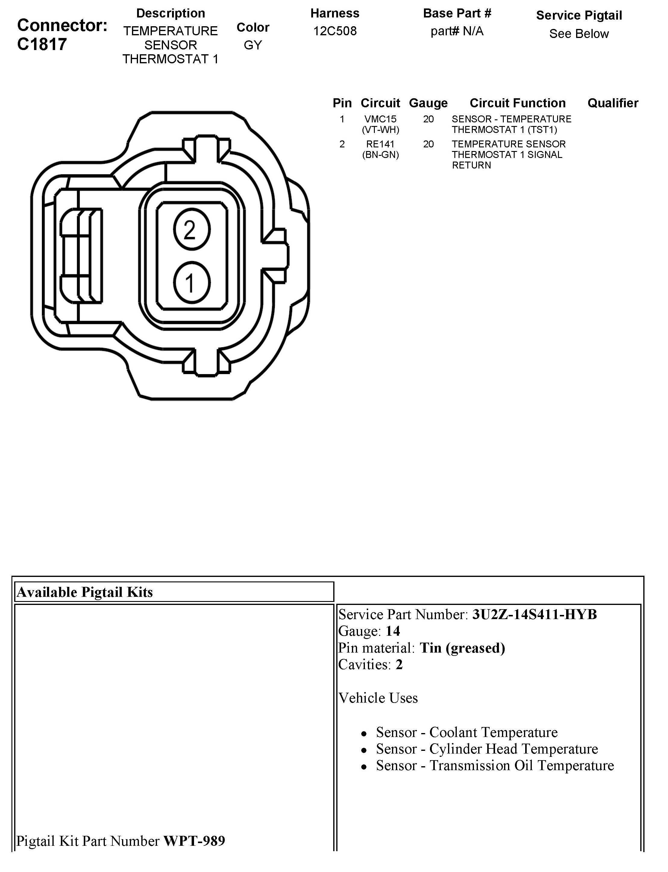

Thermostat sensor needs to be replaced I cannot locate it?
Jan 2, 2020 at 10:10 AM
BMDOUBLE
  • CAR REPAIR CONTRIBUTOR
  • 1,139 POSTS
Here are some location pictures from the manual. You can also reference the wire colors from the connector pictures to identify what sensor you have when you locate them. Check out the diagrams (Below). Please let us know if you need anything else to get the problem fixed.
